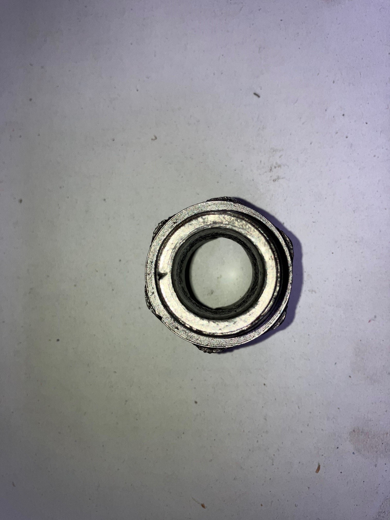

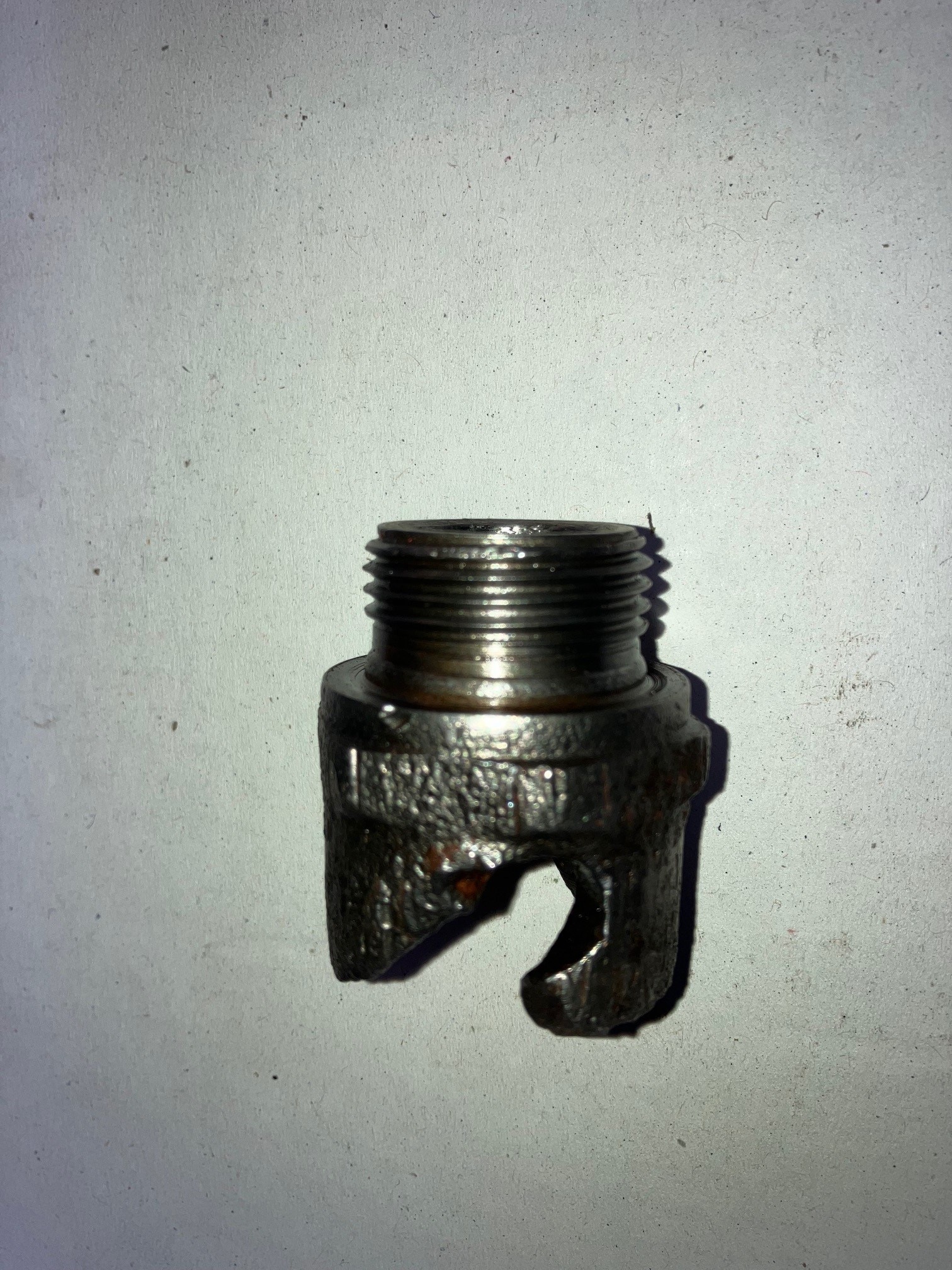

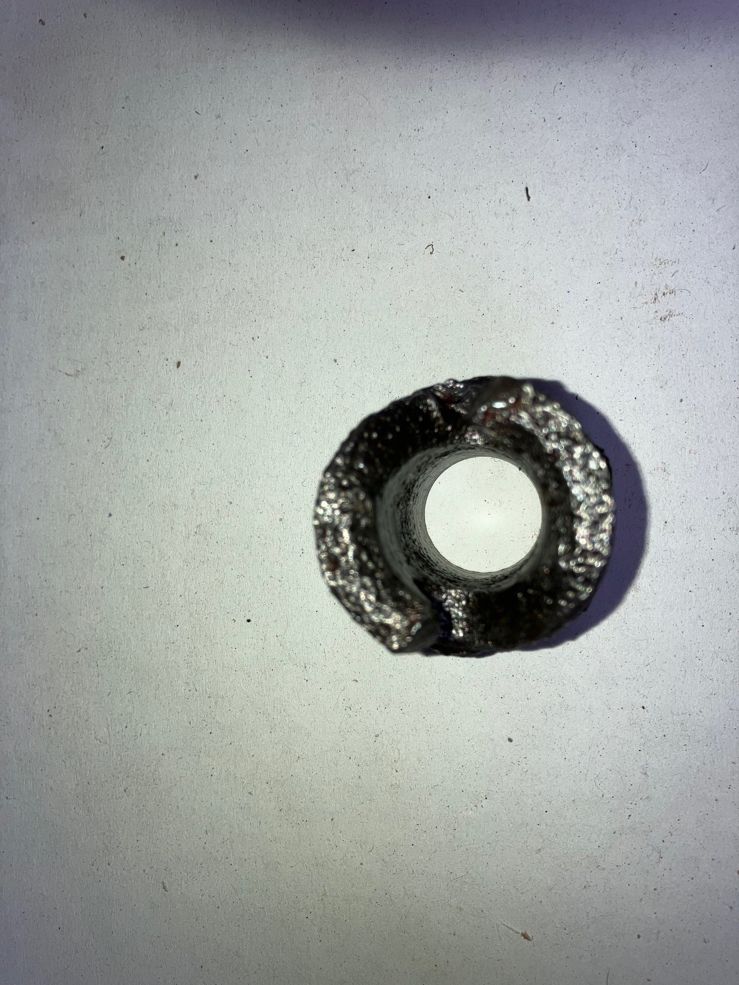

Not long ago, an old crusty damper came up for sale on eBay. The damper is not so healthy (looks like it had a puller welded onto it to remove it), but it did have a hand-crank spigot:
spigot 1.jpg (859.36 KiB) Viewed 16625 times
spigot 2.jpg (951.19 KiB) Viewed 16625 times
spigot 3.jpg (728.52 KiB) Viewed 16625 times
spigot 4.jpg (712.4 KiB) Viewed 16625 times
I suspect this is one of the original GMH industrial engine fittings. It is 1 15/32” AF.

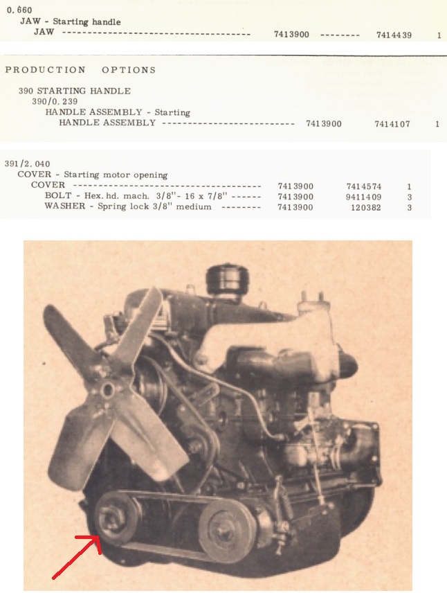

Found the missing Holden Industrial Engine Parts Catalogue:
Holden Industrial Engines Parts Catalogue.jpg (117.32 KiB) Viewed 16579 times
As an aside, some of the grey motor parts in that catalogue are interesting. High capacity sump, radiator shroud, magneto...

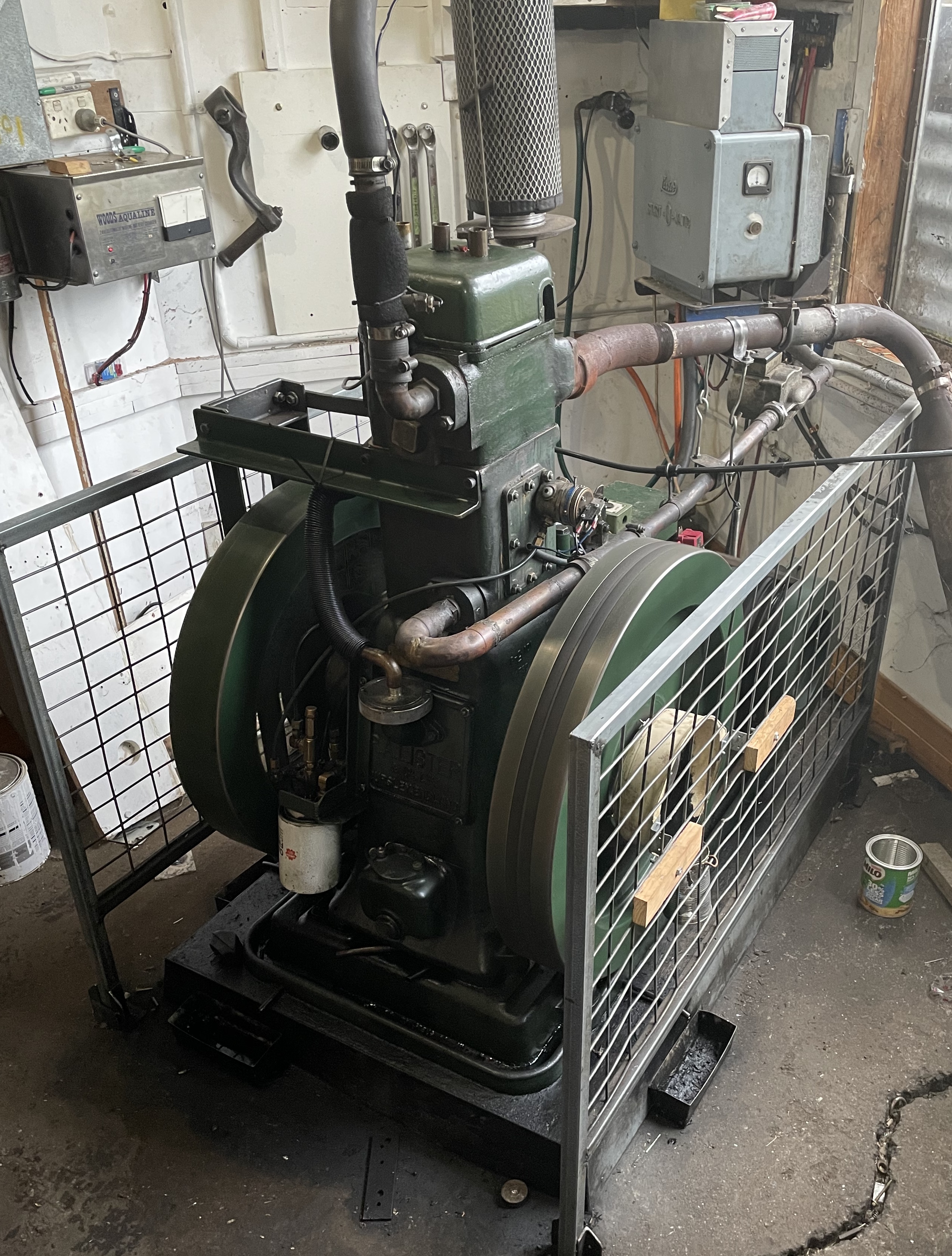

Gotta say, there is something oddly satisfying about hand cranking an engine. Grew up on a farm with 2 Lister diesel generators for house power. Learnt to hand crank this when I was 10.
Only had to do it if the battery went flat or if there was some sort of electrical problem in the switch box that converted the generator into a starter for the engine.
Hand crank is hanging on the wall.
Sorry to hijack the thread - but you did say Lister!
Scott
Posts: 2822
Re: Hand-crank for grey motor
Apologies Harv
I went to sea when I was 17 and the ship I was on had a 2 cylinder Lister emergency air compressor, if you got the cranking wrong when you dropped the decompression cocks it would throw you into the bulkhead :lol: :lol: :lol: :lol:
Quite a few guys had also broken thumbs by not getting them out of the way :wink: :roll: :roll: :roll: :roll:
Posts: 14291
funkyscooter wrote: Sat Apr 13, 2024 7:48 am Gotta say, there is something oddly satisfying about hand cranking an engine. Grew up on a farm with 2 Lister diesel generators for house power. Learnt to hand crank this when I was 10.
That's a flash setup for a farm installation - it kinda has guards over the flywheels !!!! :lol:
