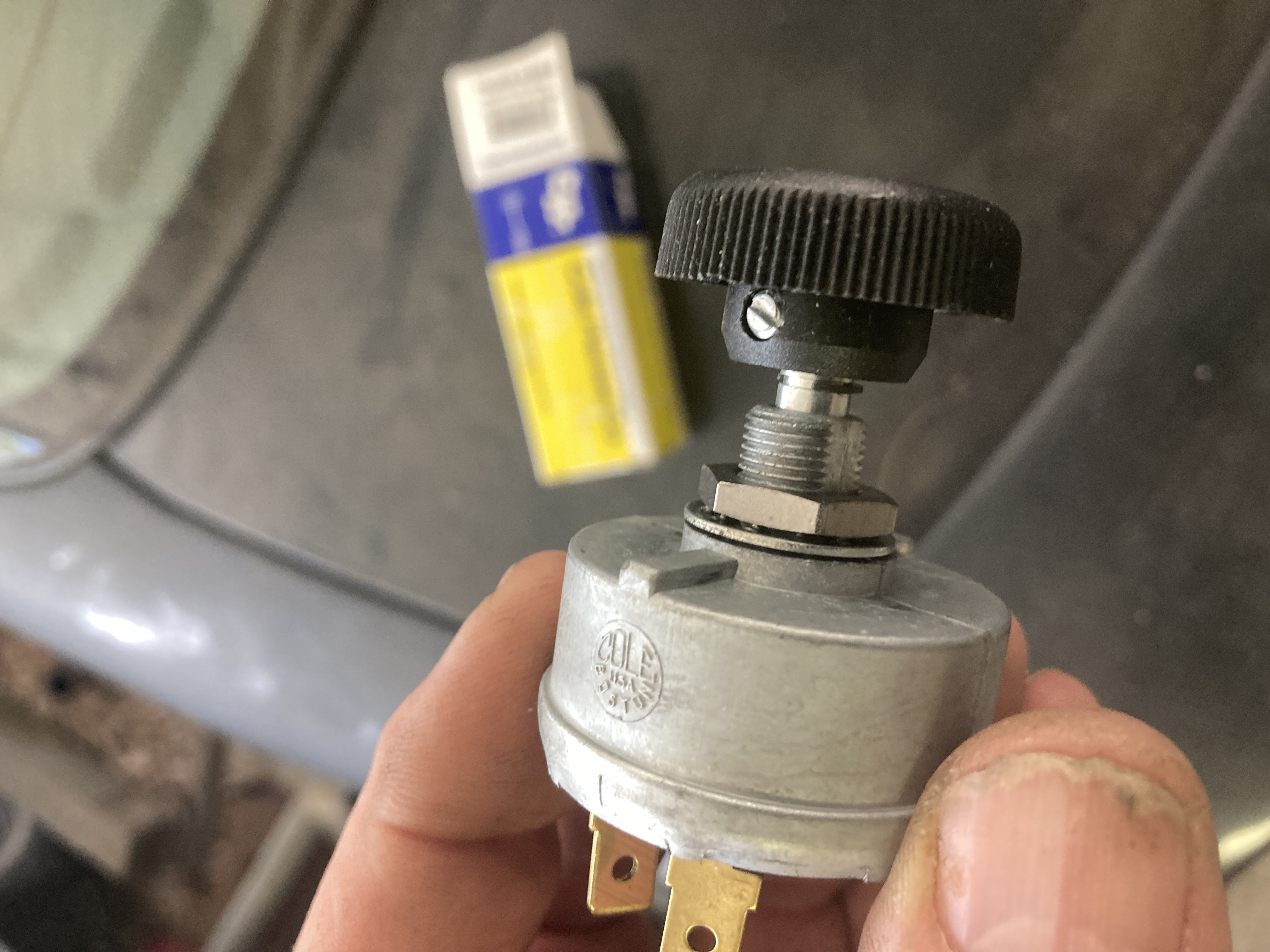

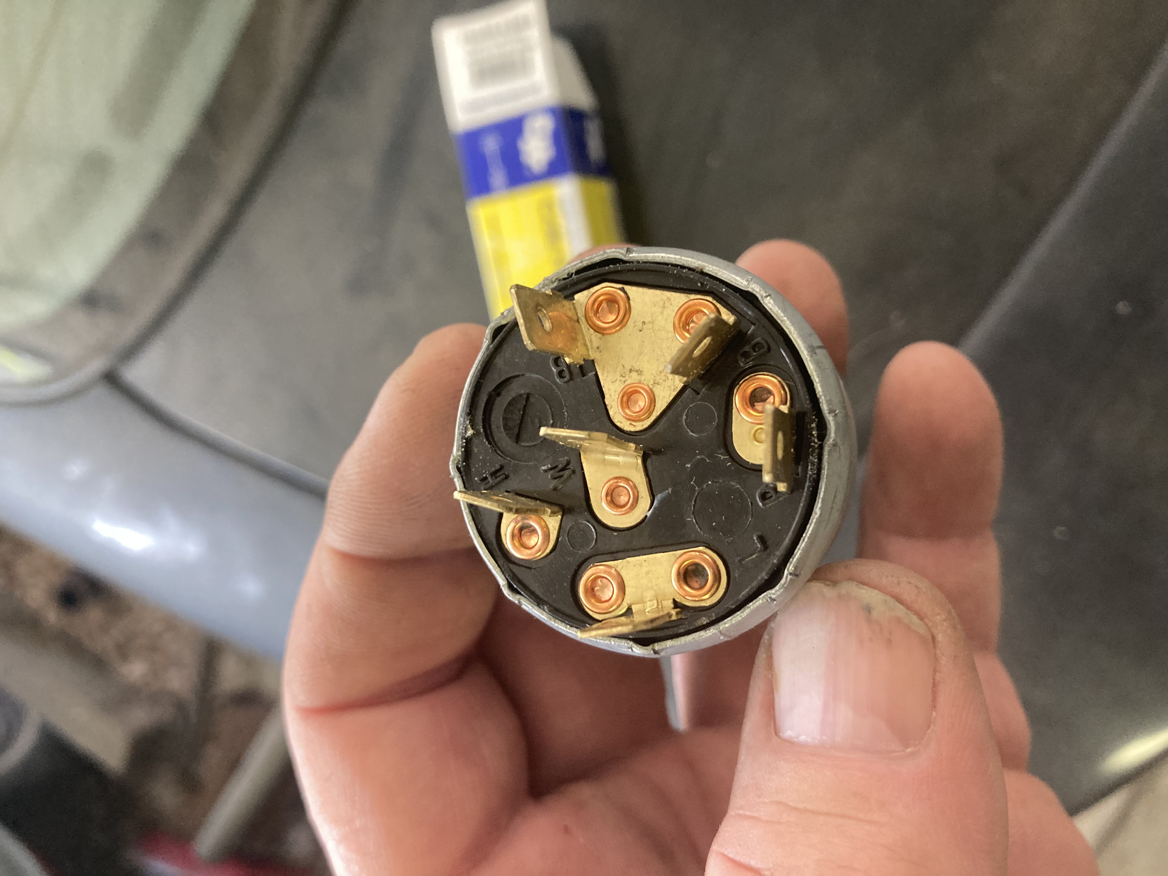

You can buy an aftermarket switch that is a straight bolt in - bezel fits, squirted function is identical, knob screws straight on etc . I have a couple at home , if you can wait until I get home on Saturday I can tell you the part number.
It is on here on a thread somewhere but I can’t remember which thread.
Re: EJ/EH wiper/washer switch - suitable or not?
Posted: Sun Dec 03, 2023 10:25 pm
by EK283
That aftermarket switch would be this.
IMG_2433 - Copy.JPG (4.09 MiB) Viewed 17117 times
IMG_2432 - Copy.JPG (4.22 MiB) Viewed 17117 times
Fits the bezel and knob fits straight on

That one works with the modern motors, by the way.
Posted: Mon Dec 04, 2023 12:46 am
That’s the animal should be around $60 Aussie
