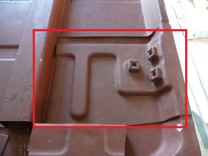

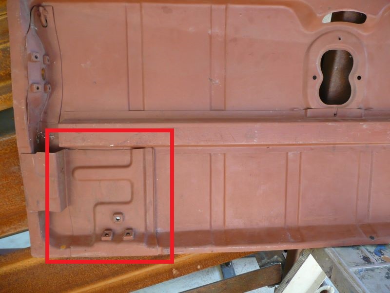

Here we have some pics of the inner reinforcing plate for the hinges on a FB/EK ute tailgate, anyone know if the wagon tailgate uses the some plate?

Hi OZ I had a look this morning at one of the roached Station Wagon tailgates that I have and have to tell you they are totally different.
The reinforcing plate in the Wagon (from what I can see) goes all the way from the hinge at the bottom up past where the side spring loaded latches come through it even seems to have a formed piece for the rod to go through (I think) if I get time today I will cut the skin off so I can get a photo.
I don’t think it has the horizontal strengthening bar either.
By the way I believe that tailgate you have is FC as it has 4 screw holes where the side latch plate goes and FB EK has only 2.

Thanks for the info!....Wagon appears to be very different to the ute, now thinking FE / FC wagon might be similar to the ute?
