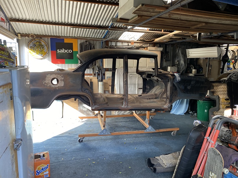

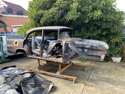

New thread for the sedan that I'm back building.
It has been 10 years since I parked this up to build Ammo's ute.
I had it blasted and undered coated way back then I stored it under the back veranda. Lots of surface rust to remove
heading to the shed.JPG (95.07 KiB) Viewed 27402 times
ready to go.JPG (246.8 KiB) Viewed 27402 times

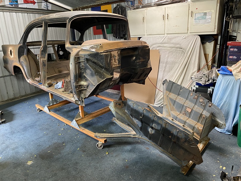

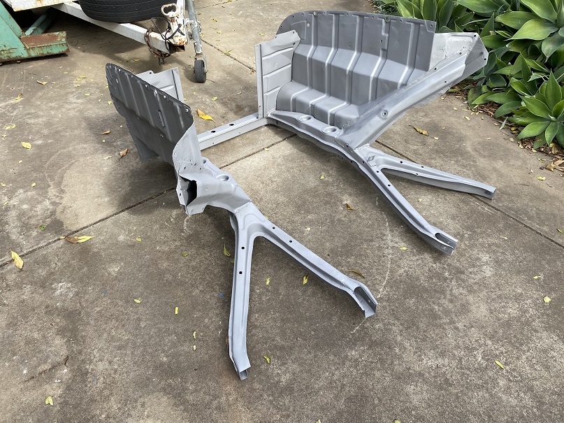

Pulled the front clip off to give me more room and on inspection to correct some of the shady work done in haste. :oops:
front clip off again.JPG (270.52 KiB) Viewed 27402 times
Using the nylon disc's and hand sanding before hitting it with an expoy. I think my fingers are a little shorter.
I have leant my lesson with these disc's and now wear my welder gloves. Light touch and no kit back yet.

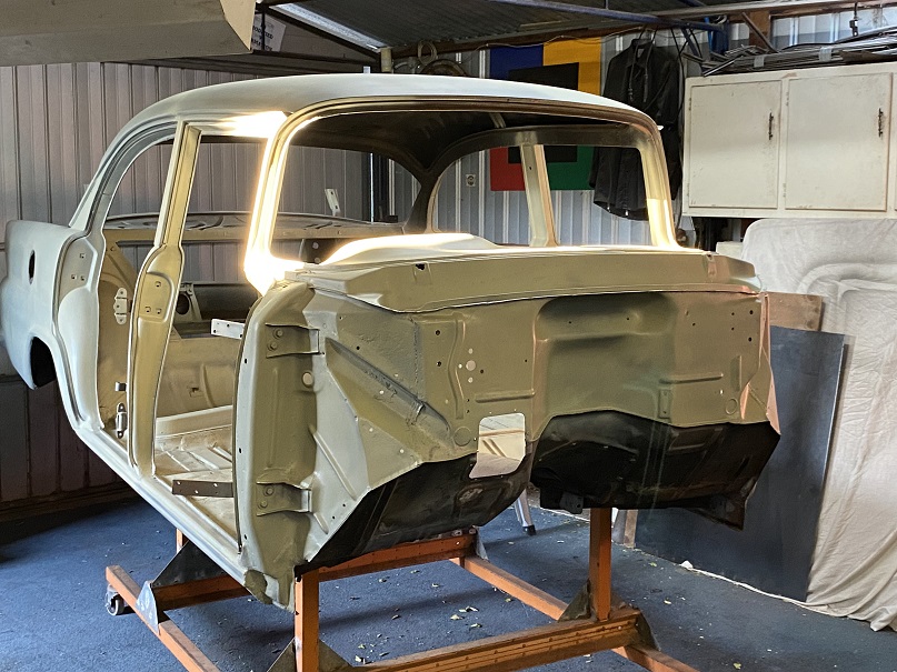

After much sanding this morning I bit the bullet, purchased 1K expoy and now I have a yellow car.
OMG, my back is killing me for the sanding and twisting and holding the bloody spray gun.
I used the mask with filters and my first beer tasted like something you would drink in Sydney. :lol:
Found a lot of dodgy welds that will need grinding out and re-welded.
I left the tunnel as is until I sort the motor and trans.

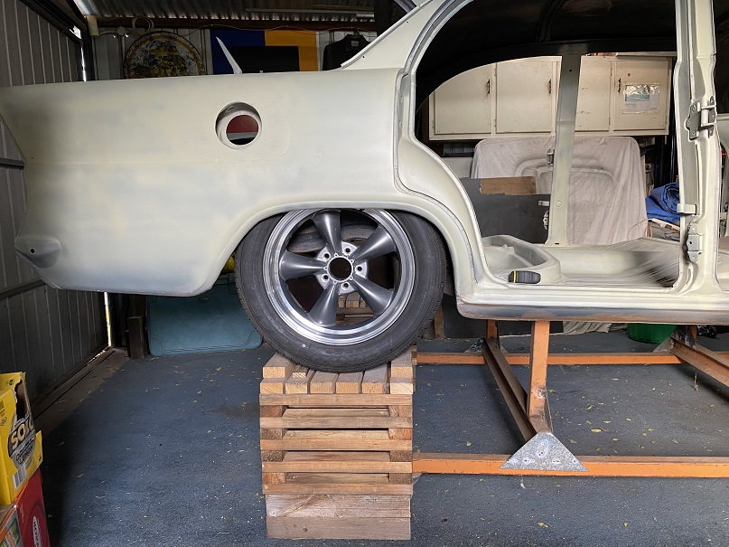

I played with which wheels to use, 17" or 15".
I do have a set of 16" but not so keen on the design now.
I think ride height is spot on and 17" fills the opening perfectly.
The 235 tyre is a snug fit.
ride height.JPG (202.03 KiB) Viewed 27241 times
I will need to do a little on the inner out side guard as I have moved the removed the filler near the chassis rail when I started this project.
Once I have this sorted then I will measure to cut the diff to size.
I purchased a VS Commodore limited slip diff that such handle the power.

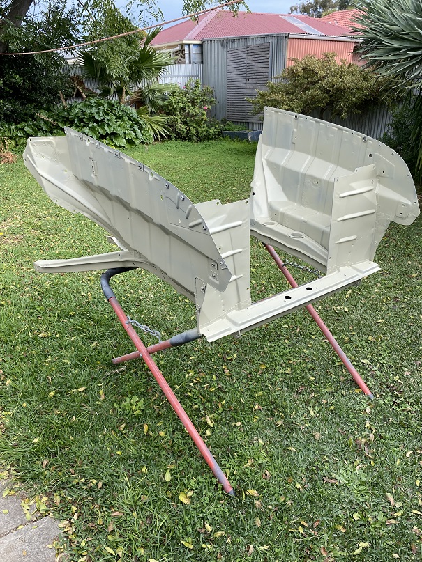

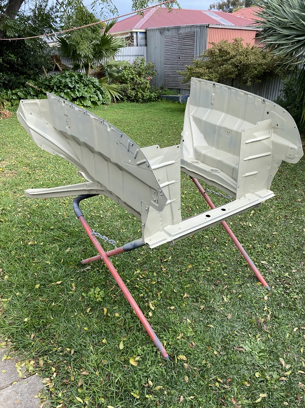

Picked up the Y frame this morning from the blaster
Set it up and a quick spray of expoy

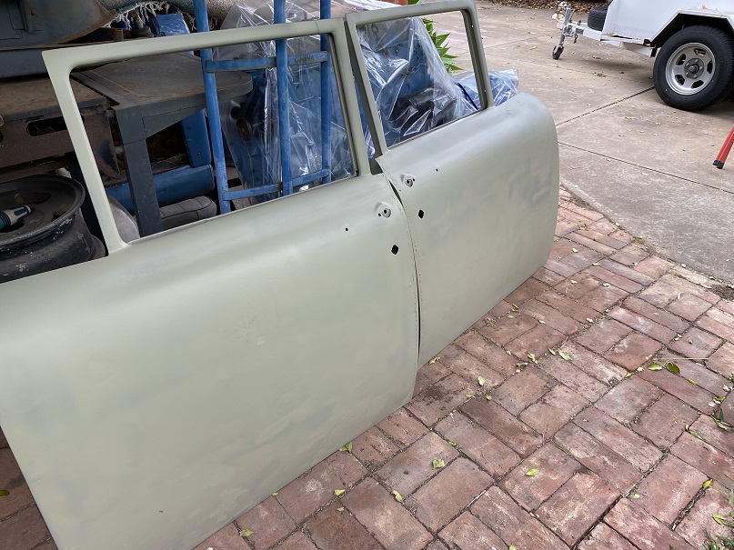

Also gave the front doors a rub to remove the surface rust and hit it them with expoy
front doors epoxy.JPG (199.41 KiB) Viewed 27104 times

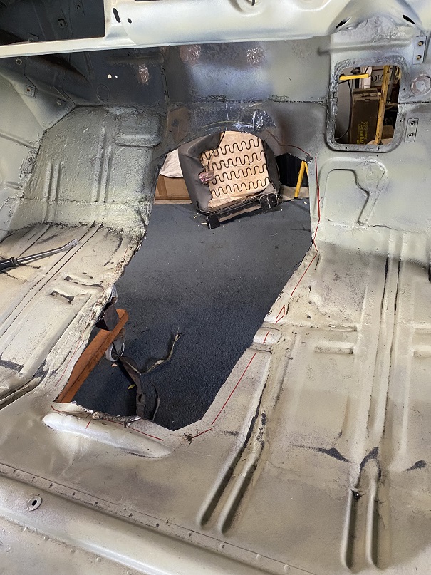

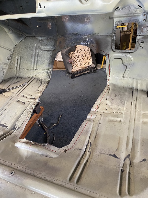

Marked out the tunnel and cut out the old modded one.
tunnel cut.JPG (224.29 KiB) Viewed 27104 times

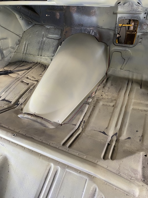

Dropped the CRS tunnel in place, a little trimming and ready to weld in.
test fitting.JPG (195.01 KiB) Viewed 27104 times
