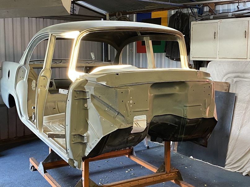

After much sanding this morning I bit the bullet, purchased 1K expoy and now I have a yellow car.
OMG, my back is killing me for the sanding and twisting and holding the bloody spray gun.
I used the mask with filters and my first beer tasted like something you would drink in Sydney. :lol:
Found a lot of dodgy welds that will need grinding out and re-welded.
I left the tunnel as is until I sort the motor and trans.

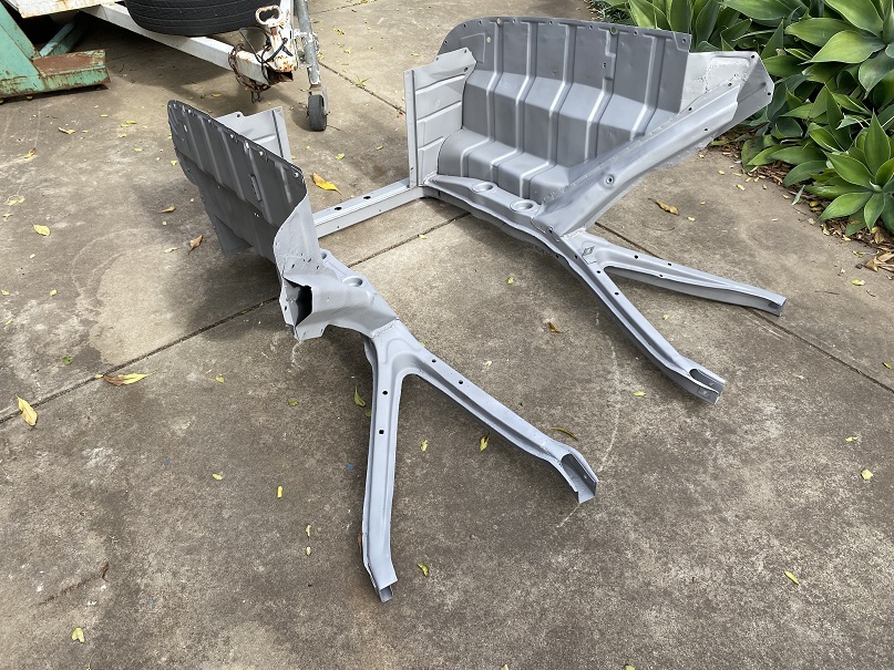

Picked up the Y frame this morning from the blaster
Set it up and a quick spray of expoy

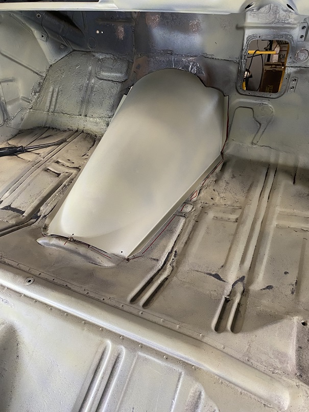

Marked out the tunnel and cut out the old modded one.
tunnel cut.JPG (224.29 KiB) Viewed 25508 times
Dropped the CRS tunnel in place, a little trimming and ready to weld in.
test fitting.JPG (195.01 KiB) Viewed 25508 times
