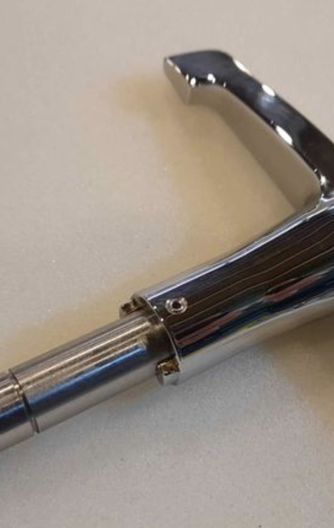

Ok. So I got the part out and the upper part just spins on the shaftImage

Can this be repaired?
Re: EK Inner door handle and tailgate outer not working
Posted: Sat Mar 04, 2023 12:59 pm
I would say yes. At least you should make every effort to do so, as they are bloody expensive. I would take it to a locksmith.

It looks
Like a grub screw may do the trick
So drill and tap a small hole ? Add a grub?

See here. Added a grub screw.

And charges $495 for them Image
