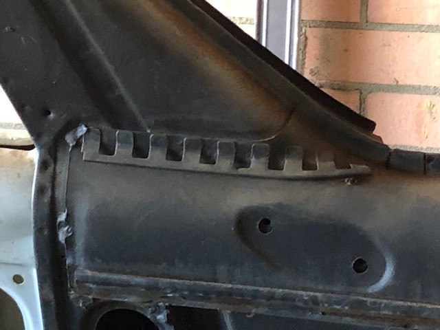

Thought I'd better try again this time in the right place. Havent had a great deal of time to put into the wag... been thru most of the boxes but the big ticket item was getting it moved to the other side of the garage so the wife could park her car... Few little things I did find which will need attention early on- anyone had experience with a fix for rusted out roof lining retainer strip?
this is the RHS in good nick
LHS strip looking pretty average??

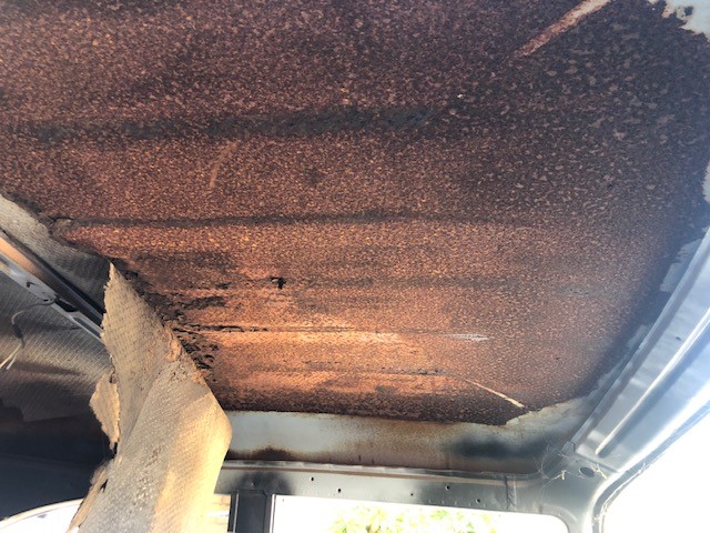

Also after some feedback on the best way to address the surface rust on the inside of the roof... poking around a bit revealed this surface stuff all the way thru under the sound deadening material
. Whats everyone's preferred treatment for this kind of scale..?? Blacky suggested the wire wheel but having a look through I like the idea of Rogers plastic wheel (by the way Roger thats some nice artwork on your forearm you incurred on the clean-up of Ammo's Ute- hope that healed up OK for ya..) Best rust converters?

Yes, my van has those rusty retainers melly. Easy enough to replicate, or use a different secret fastening method.
Wire wheel on the drill will eat up the surface rust. Plastic is better on paint. Start with the wire then clean up with the plastic strip disc, which will get you shiny metal. Stanley knife to chip off stubborn scale the brush can’t lift.
Phosphoric redox treatment on any remaining solid oxide, then few coats 2k epoxy etch. It is impervious, job done.

If you use the wire wheel method, just be mindful of moving the wheel around and not making heat in one spot. The wagon roofs are a looooooong panel... any distortion from heat becomes very visible in the finished paint.

We forgot to check EKmart for a retainer while you were here but I reckon we can rustle one up if the trimmer decrees we need one.
