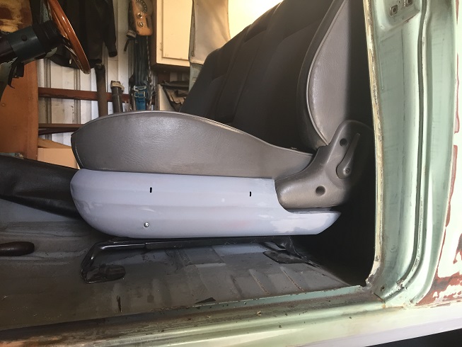

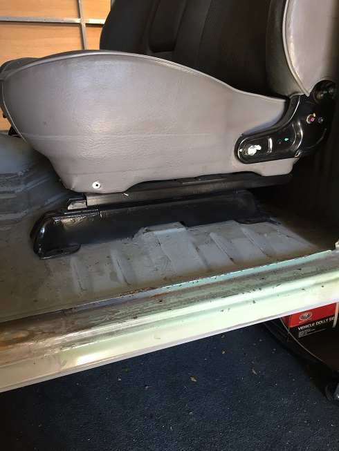

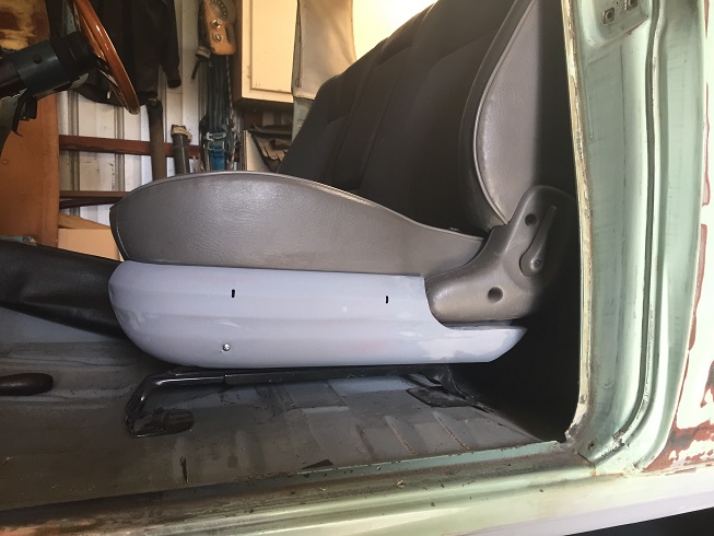

Did a bit more last night , was going to do it yesterday but the young bloke needed a hand to pull the cab off his HJ45 Cruiser
Excavators are such a useful device ImageImage
Anyhoo , front mounts needed to be lowered somewhat as the seat was in full boy racer hat backwards mode , measured them up and they needed to be cut like so
Cut and welded , dummy fit and found to be good - aforementioned son nowhere to be found to give me a hand to remove seat for final welding so left for today.
Re: Blackys Bench Bucket bracket bodging blatherings
Posted: Tue Apr 12, 2022 9:57 pm
Brackets finished off,fitted and seat bolted back in , next step is the console, I want to mount it to the seat about 100 mm off the floor, so I don’t need to drill holes in the floor to mount it plus it will move with the seat.
