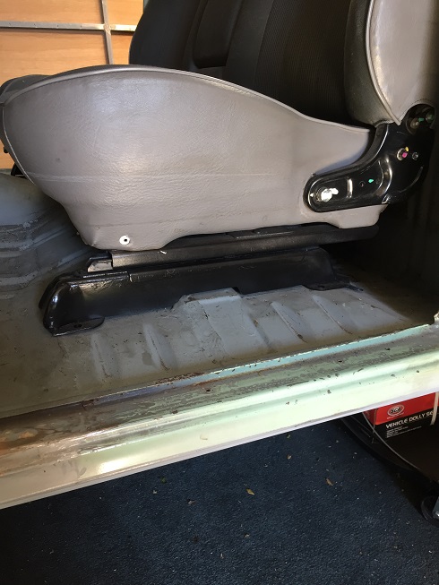

First up I removed the front seat out of the wagon seeing as it s a whole lot easier to remove then a ute seat plus you can see the back of it to figure out how best to mount it.Image

So I wandered up to EKMart and found a pair of old seat mounts and got to work - removed the Mazda ones and sat them side by side on the bench , the original ones have a curve in them , the Mazda ones are straight so a direct fit wasn't going to happen.
So next trick was remove the bases off the Holden runners and adapt the Mazda runners , this involved drilling the Holden rivets out and carefully removing the ends of the Mazda runners with a hand held milling machine.
Posts: 14285
Blackys Bench Bucket bracket bodging blatherings
Mounting positions were drawn on the bench as well so I could line them up , a couple of extra holes were drilled in the Holden base and the rear brackets were welded onto the Mazda runners , runners bolted back onto the seat and then installed the seat into the wagon.
Height seems OK at the rear , I ran out of time to play with it today as I had some other errands to run. The front is too high with the stock bracket plus it sits at the wrong angle so I am going to need to take a piece out of it and then weld it on. once I am happy with it - then its off to Drews at Northside Motor Trimming for a retrim :D Flew out this arvo so had to call and early end to shed time :esad:
