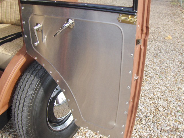

I'd like to make a set of bead-rolled door trims for the meth monster project, similar to this:

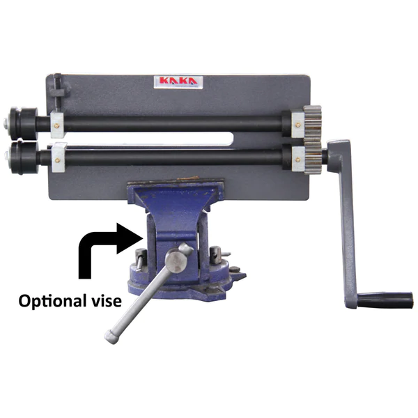

If it comes freestanding, then yes. If it's one of these, then I will stash it somewhere:

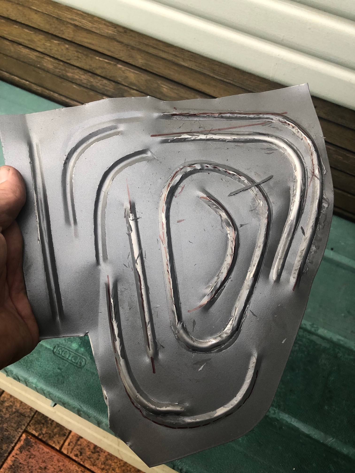

I bit the bullet and bought one of the Kang bead rollers shown above. It's nothing flash, but should do what I need it to.
Had a quick play with some scrap painted steel sheet (the weird stuff in the photo is where the paint is spalling off). Fairly easy to use, but will need some more practice before doing the door trims. Straight lines are simple, as you can sight the texta mark in the "u" of the die. Following a tight curve is harder as if you line it up to the "u" at the edge of the die then the place you want to bend (under the centre of the die) can be offset.
