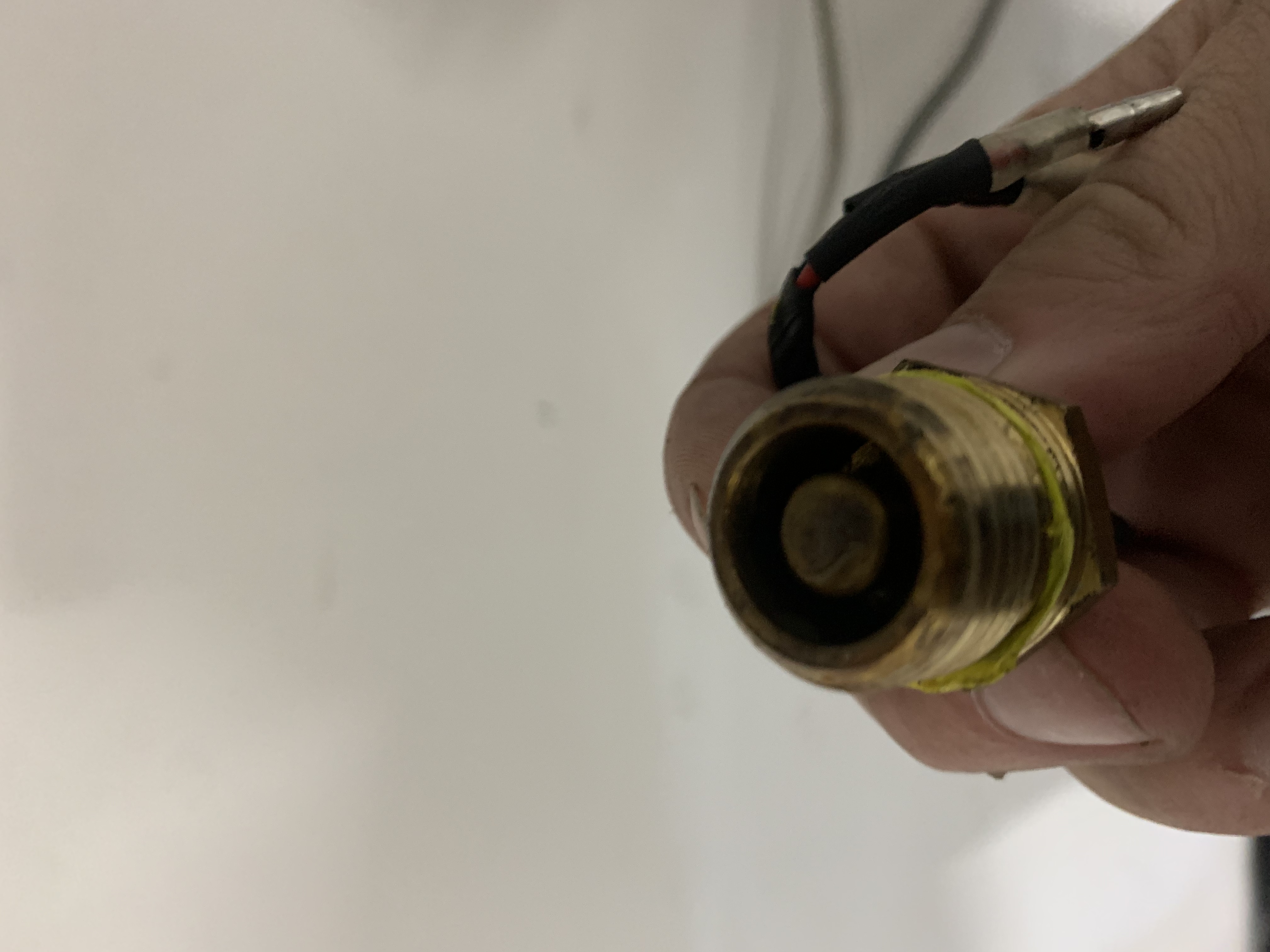

I noticed at idle the temp on the elec gauge would slowly increase to 100 if idling for 10min oh a relative cold day ambient 15degree.
I removed and recorded the radiator, as I didn’t know the history. At the same time I fitted a mechanical temp gauge where the idiot sender is fitted from factory. The Mechanixal gauge sits on 82degree. I also fitted a high flow stat then the radiator was out. 177f.
My question is is it normal for the rear of cyl head to get hot?
My next move is to swap sender positions and see if the mechanical at the rear gets to 100 like the electronic gauge?

Update.
I fitted the mechanical gauge to the rear of cylinder head, and upon removal of the electric sender, I found the adaptor fitting used, didn’t allow the sender to protrude and measure a good reading.
With the mechanical gauge in the rear port it was idling perfect. Sitting on the thermostat. 77 degree.
I think I will stick to a mechanical gauge.
Thanks all.
Thanks all.
