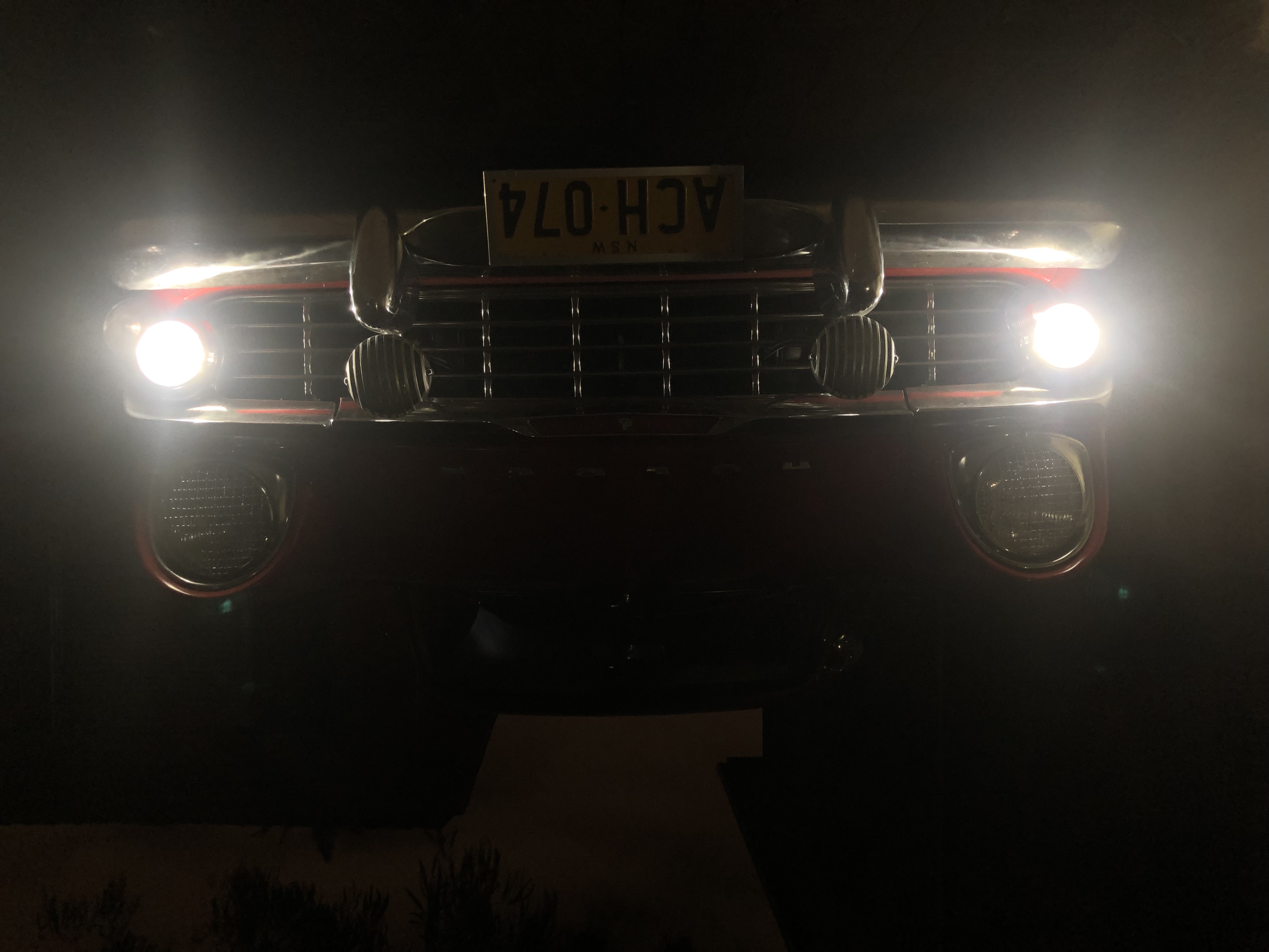

Wagon has H4 halogens, 130/90s. The reflector buckets bolt up, easy relay wiring. Bright enough that you would think I am scared of the dark :lol:
Graces ute got the halogen bulbs that slip into the original reflectors. Low enough current that they do not need a relay, but good and bright.
