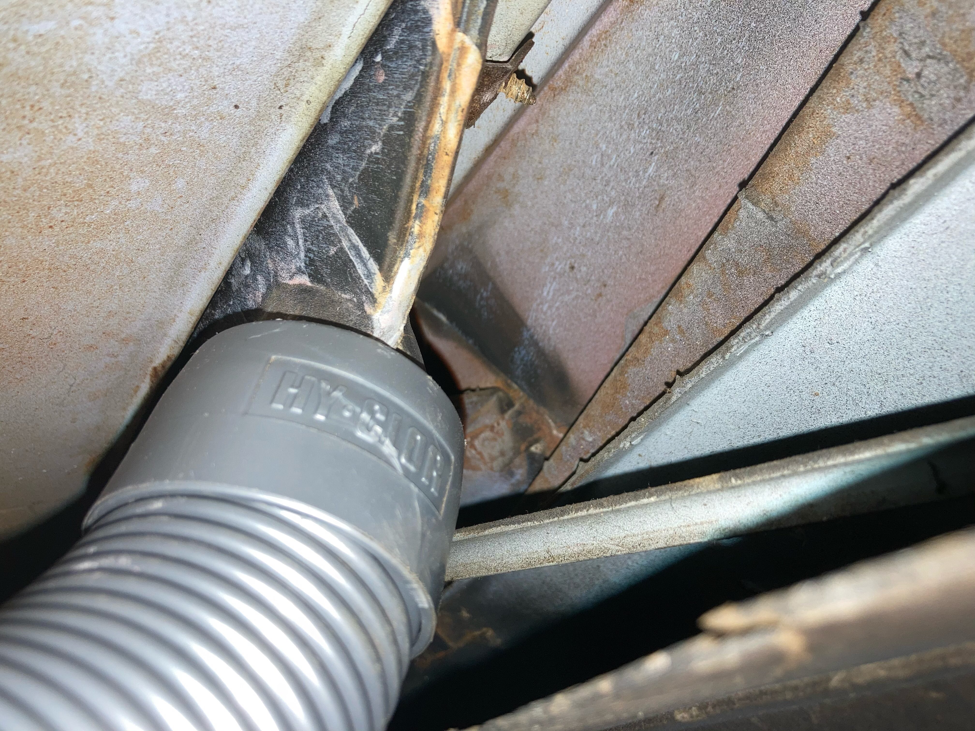

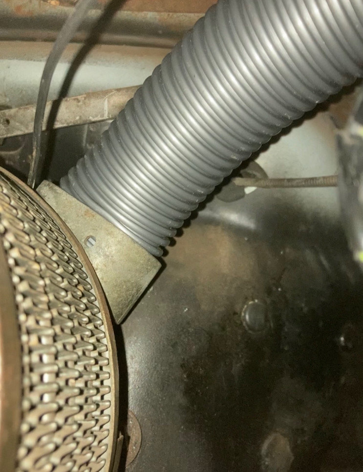

Hi.
After crushing several ducts made by fuelmiser (the black aluminium foil wrapped in cardboard) I was looking for some spiral wound product to do the job.
First though of a vacuum cleaner hose. One of those cheap ozito ones.
But stumbled across these 1m lengths of pool hose product. (Bunnings)
Comes in grey. (White or aqua)
What’s good is it won’t crush, fits tight onto the dash vents and can squeeze in to the heater outlet that’s oval shaped. And from what I have tested, handles the heat well.
Not factory, nor period correct. But it works and you can’t see it unless you go looking for it.
No shower squeegee hanging off the dash for me this winter!! Clear windscreen all the way.
Nostalgia isn’t what it used to be.
