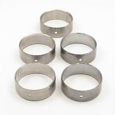

Were the cam bearings changed? Only one of the bearings has two holes... if a one-holer went into the wrong spot (or rotated), then no oil feed to the rockers.

Thanks Harv,the cam bearings where changed.The bearing that corresponds with pump line has 2 holes one at the top that runs to gallery that feeds overhead assem and one that faces inwards towards crank.Is that right or should the hole be at bottom directly above pipe gallery .

Not sure - been a long time since I've looked at a set of cam bearings installed to check orientation. I'm on the road for work, so cannot check one of my spare blocks.

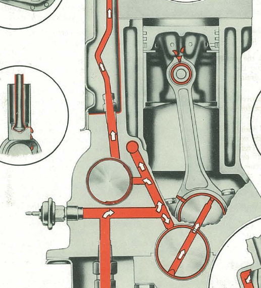

The workshop manual suggests 1 o'clock and 3 o'clock, but may be more an artists impression than reality.

I tried blowing air in the oil pump pipe line hole to see if it run through to the cam bearing , no air coming through that way.Looking at diagram air should come through cam bearing.I poked a piece of wire in the hole that corresponds with cam bearing it lines up ok.The hole that was drilled through main bearing diagonally must have a dead spider or something blocking that hole.
