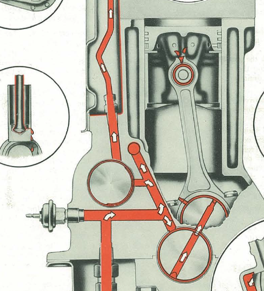

The workshop manual suggests 1 o'clock and 3 o'clock, but may be more an artists impression than reality.

I tried blowing air in the oil pump pipe line hole to see if it run through to the cam bearing , no air coming through that way.Looking at diagram air should come through cam bearing.I poked a piece of wire in the hole that corresponds with cam bearing it lines up ok.The hole that was drilled through main bearing diagonally must have a dead spider or something blocking that hole.
