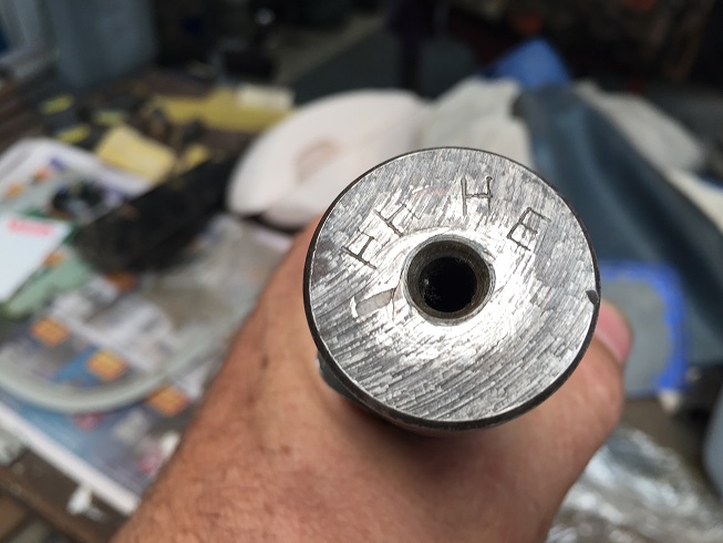

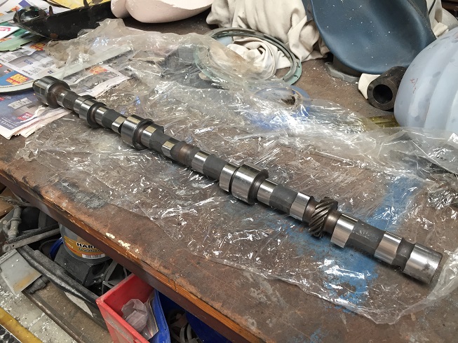

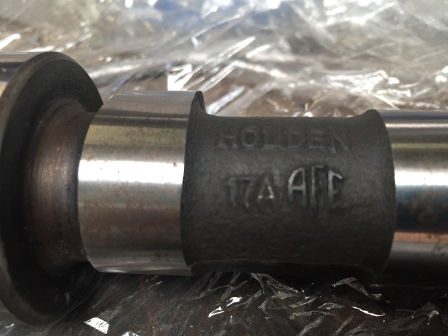

While have your attention, can you id a cam for me. It's grey motor cam that I was given by Thommo. He can not remember if standard or modified.

I'll say standard (possibly, because the base circle of the lobes is still higher than the shaft itself); but it may also be a very mild grind (because of the stampings at the rear).
Tell you what - if you've got a digital caliper, measure across the cam from base circle to lobe peak, and I'll compare with a standard cam . . . no, it's not quite that easy . . .
Give me two measurements: one from lobe peak to base circle (the maximum reading you get as you rotate the cam inside the jaws of the caliper), and another at right angles to the lobe peak (the minimum reading you get as you rotate the cam inside the jaws), and I'll compare against a standard cam.

Hi Rob,
From lobe peak to base circle - max measurement- 1.367"
and
right angles to the lobe peak - min measurement - 1.128"

Roger,
1.417"/1.186" exhaust
1.411"/1.186" inlet
Your max is about 40-50 thou less than a standard grind, and your min is 60 thou less than a standard grind. I'm thinking that you have the mildest possible regrind: about 0.015" more lift at cam. Maybe a 15/55?

I wonder whether HHHE is code for 55 51 (i.e. 15/55).

You could be correct, in that it is code for who ever ground the camshaft.
