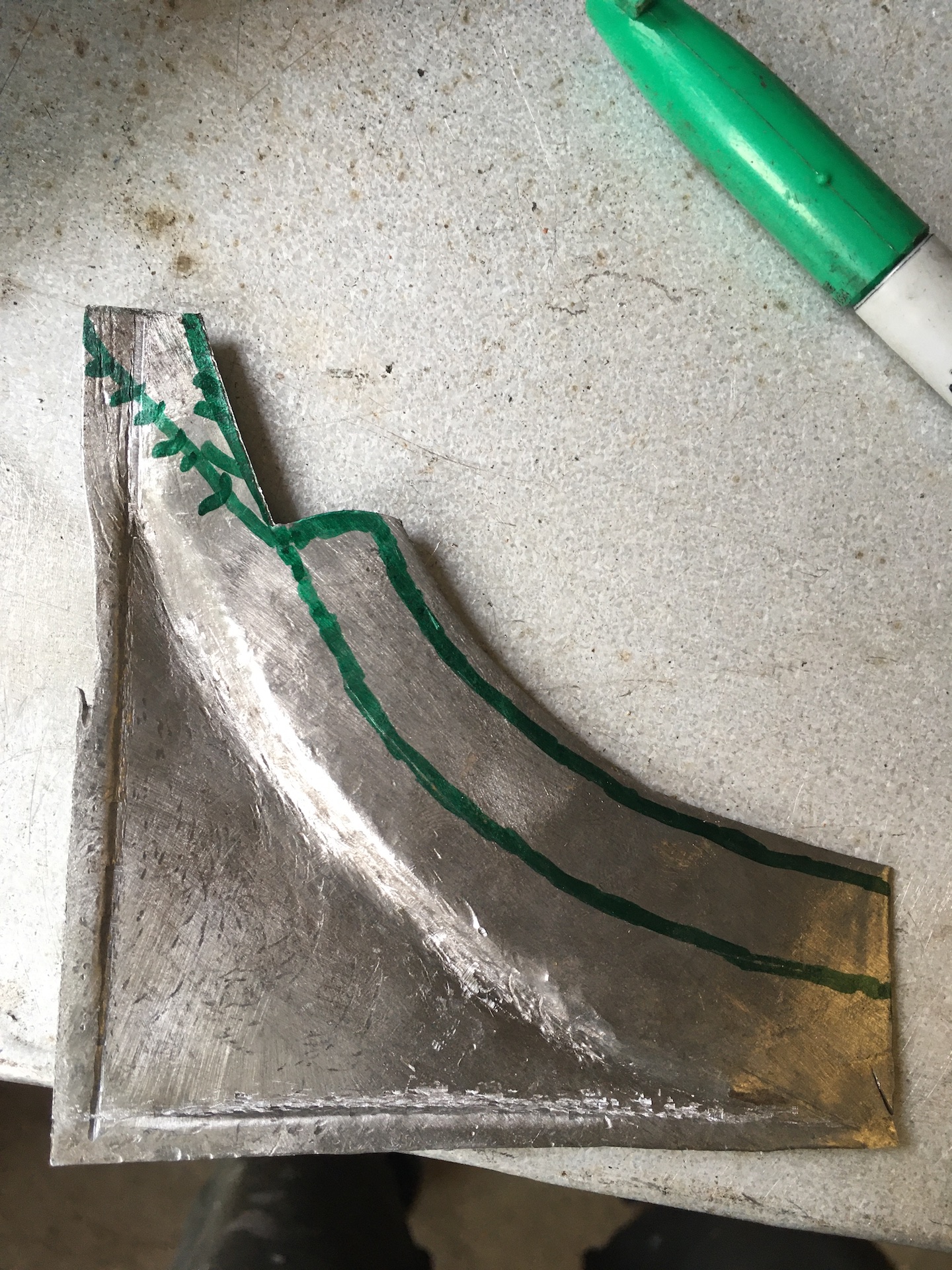

At this point its starting to look ok so I gave it a wire brush to get the surface rust, adjust my curve and used a blunt cold chisel to get more definition.
Gives this.
And the other side. Starting to take shape.

Mark up lip and cut. Left a bit big so I can cut down to the same height as the exiting channel
Start to bend up with vice grips
Second pass.
This bend is forcing a nasty curve in the piece.
Compounded by the fact that the A-Pillar curves a bit the other way.
Time to use that gained knowledge. Stretch the bend over lip by hitting it repeatedly using the thin flat end of the hammer over my 'anvil' That was 2 passes.
Took about 6 passes to straighten it.
Another 4 to force it to curve the other way. You can actually feel it releasing the bend as you hammer. The metal on the lip was about 0.8mm by the end

The final result. Pretty happy with it - going to look better than my weld up. At least that's the plan. Too hot to weld it in. 40C in the shed.
