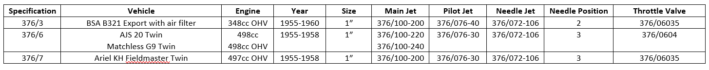

The 376/202 carb is a bit of a weird one. I can't find a listing for it - could be either Amal's listings are incomplete, or it has been miss-stamped. 376/200, 376/208 and 376/209 are all 1" carbs, whilst 376/206 and 376/207 are both 1 1/16".
376/i1 is a weird one too. Could be 376/1 or 376/11, but in either case both are 1 1/16" carbs.
Looks like you have two carb sizes. Some are 1":
one inch.png (22.06 KiB) Viewed 2649 times

If it's OK, can I please have either three 1" carbs, or three 1 1/16" carbs. Choose whichever batch seems to be most complete. I'd lean towards three 1 1/16" carbs (the two 376/303's and the 376/1) if possible. Let me know what I owe you.
