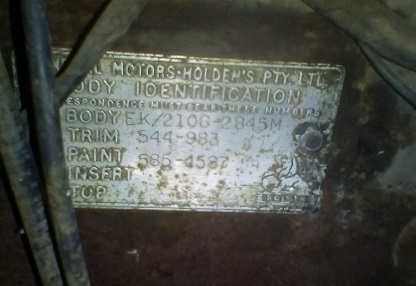

Body ID plate says EK. Bonnet says EK. Interior says EK. Front guards, bumper overriders, grille and indicators say FB.
Posts: 2705
Re: Gimme 5 years
Im going EK,
Windscreen cowl is EK as well.

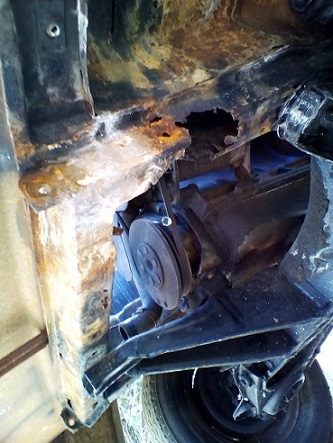

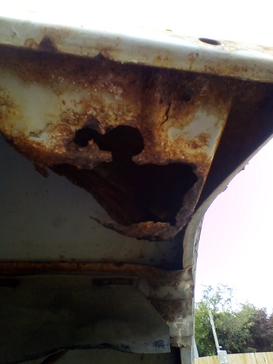

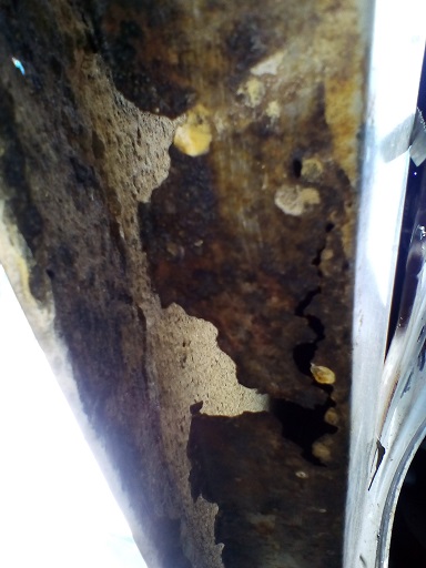

bonnet support
bottom of door
door bottom.jpg (120.56 KiB) Viewed 6660 times
inner sill
outer sill
anti sway bar mount
swaybar mount.jpg (129.49 KiB) Viewed 6660 times

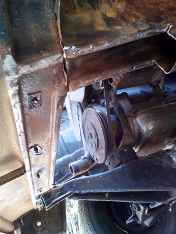

passenger side front corner of subframe had previously had 'something' welded into it and covered with putty - no drain hole - probably just to get it through rego one time... (btw some of the floor has been 'fixed' with tin and pop rivets)
swaybar mount.jpg (129.49 KiB) Viewed 6644 times
got the spot weld drill and angle grinder onto it
swaybar mount 2.jpg (131.88 KiB) Viewed 6644 times

The utes had an inner, outer and a third internal strengthener in the sills, cut them out and replacing isn't as hard as one would think. If you do that though make sure there is some bracing so the body wont twist, especially if you have the floors out as well.
Its just rust no big issue just time and patience.

Yes you’ve got some work ahead of you. If your bonnet is straight, you might pick up a bent one with solid corners, but it is a common rust area. They fill up with leaf matter and dirt, forming a rust poultice.

Get the door gaps right and tack them to the B-pillar at the bottom rear edge near the sill. Then you can turn it upside down or flip on the side and fit new inner sills. The doors can then be reopened to facilitate floor pan replacement, then finally outer sills, which must be done with the doors on. Repairing and attaching the bottom of the panel rear of the B-pillar is tricky. Haven’t worked out how to do that one yet.
