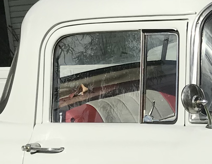

Errol62 wrote: Fri Feb 14, 2020 9:22 am I have used soft channel for all but abutting the front and rear quarter windows in my sedan. I believe this is the standard practice. In commercials of course you have to use soft due to the curve in the rear corner.
I thought the commercials had the chrome-stripped bailey channel too (?). You can definitely fit it to the curve without any drama:
Ute bailey channel.jpg (131.63 KiB) Viewed 16226 times
