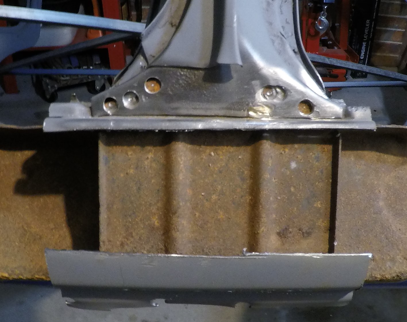

So I managed to remove the bit of the outer sill from the B pillar. There were a number of spotwelds from the inside that I should have looked harder for.

And I had to sacrifice the brace bit to do it.

Dave
62 EK Sedan in slow progress
Posts: 11258
Re: Outer sill removal from B pillar
You can always fabricate a new one before you put the new outer sill on Dave. They tend to be rusted through at the bottom anyway. Have you got the pillar braced up? It’s a good idea to hang the doors and get them lined up with the new sill when you refit the b pillar.

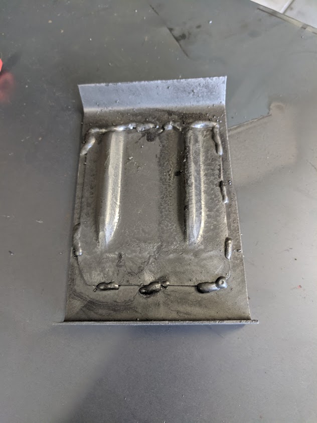

Perfect timing. Great photos Dave. I have just fitted inner and outer sills and had no b pillar to speak of at the sill joins. The brace was also not evident in the remnants. For those using a rare spares outer sill ( I think it's a great panel) there is a dilemma with this brace because the sill comes complete with the b pillar hump already stamped in, so that when you install the new outer sill with the inner, unles you cut it open you cant fit the sill with the brace in place. I see some, such as the Old Timer restoration, used the existing b pillar bottom and cut that piece out of the new sill and then butted it to the new outer sill. In my case, there was no remnant to use. So, the dilemma becomes, cut up the hump and install the brace before fitting the outer sill, or cut open the sill and install the brace after the pillar is welded to the hump (risking the look of the outer sill).

Thanks mate. I've worked a get around. Made a brace and fed it up between the inner and outer sill and then welded top to pillar base and bottom to inner sill lip. So same angles but slightly different mounting points.
I'll have a bit more of a think when I do drivers side sills as it was a major fiddle.

New brace
b pillar brace.jpg (77.89 KiB) Viewed 1136 times
