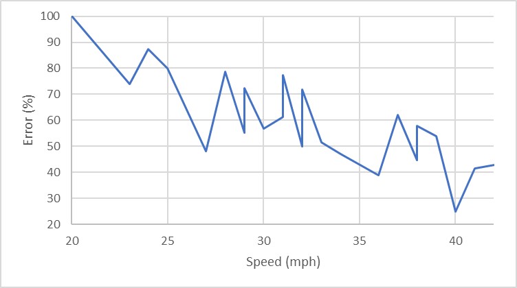

Some more data points with Number 1 son are shown below.
Speedo error.jpg (38.69 KiB) Viewed 2385 times
I recognise the readings are only to 60km/h, but need to limit the testing to something sensible - NSW law lets you drive unregistered to test (or repair) after an inspection, but I'm figuring a 100km/h run up the M4 might be pushing the limits. There is some noise in the readings, though they seem to say that the speedo error is not a simple % - the speedo is out a lot at low speed, and gets better at higher speed. A simple ratio change will not fix this.
I'm figuring the speedo head is crook, possibly dirty/corroded/gummed up internally (if anyone has a better explanation of the results above, please let me know). I could swap it for another one (I have one spare), but by the time I get it out and swap the fancy face over I may as well get it repaired.

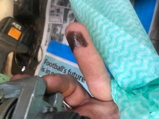

ardiesse wrote: Mon Feb 11, 2019 5:56 pmyou will need to get some solvent in to dissolve the gunk, and then re-lubricate with sewing machine oil. WD-40 works well as the solvent, but it may take a day or two to free up gummy lubricant.
Solvent going in...
... and some gunk starting to come out:
ardiesse wrote: Mon Feb 11, 2019 5:56 pmPatience, Grasshopper. Only when the speedo drive shaft feels completely free by hand should you oil the shaft.
Yes Master Po. I now see the great clarity that instructs your efforts.
Sadly back to work again, so the WD40 has a lot of time to work :oops:

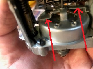

ardiesse wrote: Mon Feb 11, 2019 5:56 pmInside the speedo is a "zero-adjust" which the hairspring anchors to. It looks like a metal arm projecting out from the Nikola-Tesla-rotating-magnet-eddy-current-cup-thing. It's used to set the pre-load of the hairspring when the pointer returns to the zero-stop. If you move the arm, you can vary the speedo error - but it's a uniform error, independent of road speed. So, for example, you may have to get going at 15 mph (say) before the pointer moves off the zero stop. At 30 mph indicated, the road speed is 45; at 60 indicated, you're doing 75, and so on.
The outer end of the hairspring is retained by a taper pin. If you change how many turns of the hairspring are active, you can correct for scale errors in the speedo (think y = mx + b. The zero-adjust above changes b, varying the number of active turns of the hairspring changes m). This will change how the speedometer relates to the odometer, though. I have a suspicion that most speedometers are set up so that 1000 input rpm should give 60 mph on the speedo, one mile per minute on the odometer. Let me see. 60 mph, 3000 engine rpm, times 8, divided by 23 = 1030.
I'm guessing it is this doglegged arm, and that to adjust the taper pin you rotate the arm?
There doesn't seem to be much holding it in place... perhaps lift slightly and turn?
