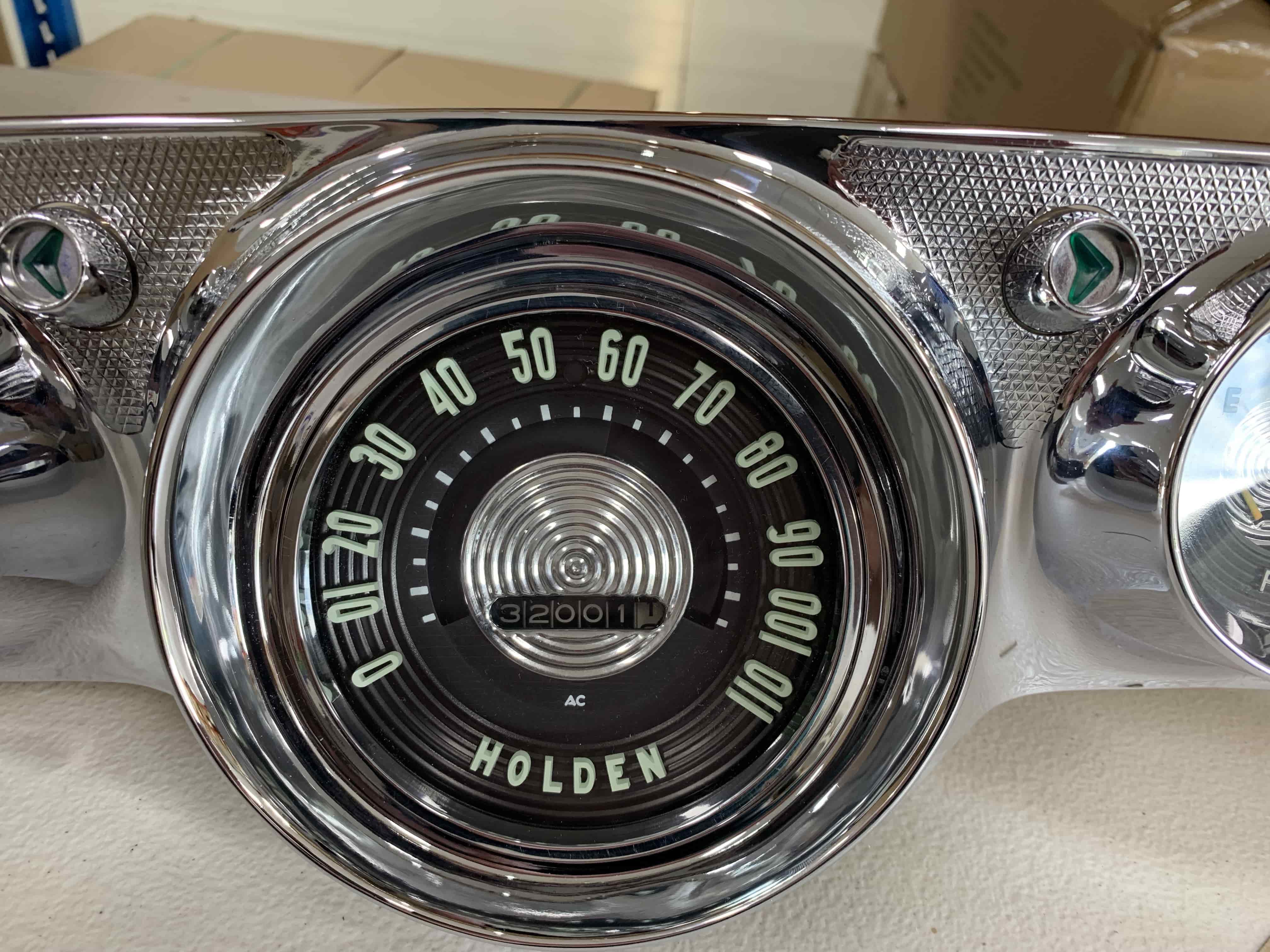

What about a cosmetic resto ? Has anyone repainted the green numbers on the clear bit of the speedo ? I have one that needs a clean up ? Maybe need the metal bits repainted/reprinted too ???
Re: Speedo gurus... any reccomendation for Sydney?
I had mine done recently Blacky - came up mint.
Was arranged by the panel beater but I can get a contact if you like.

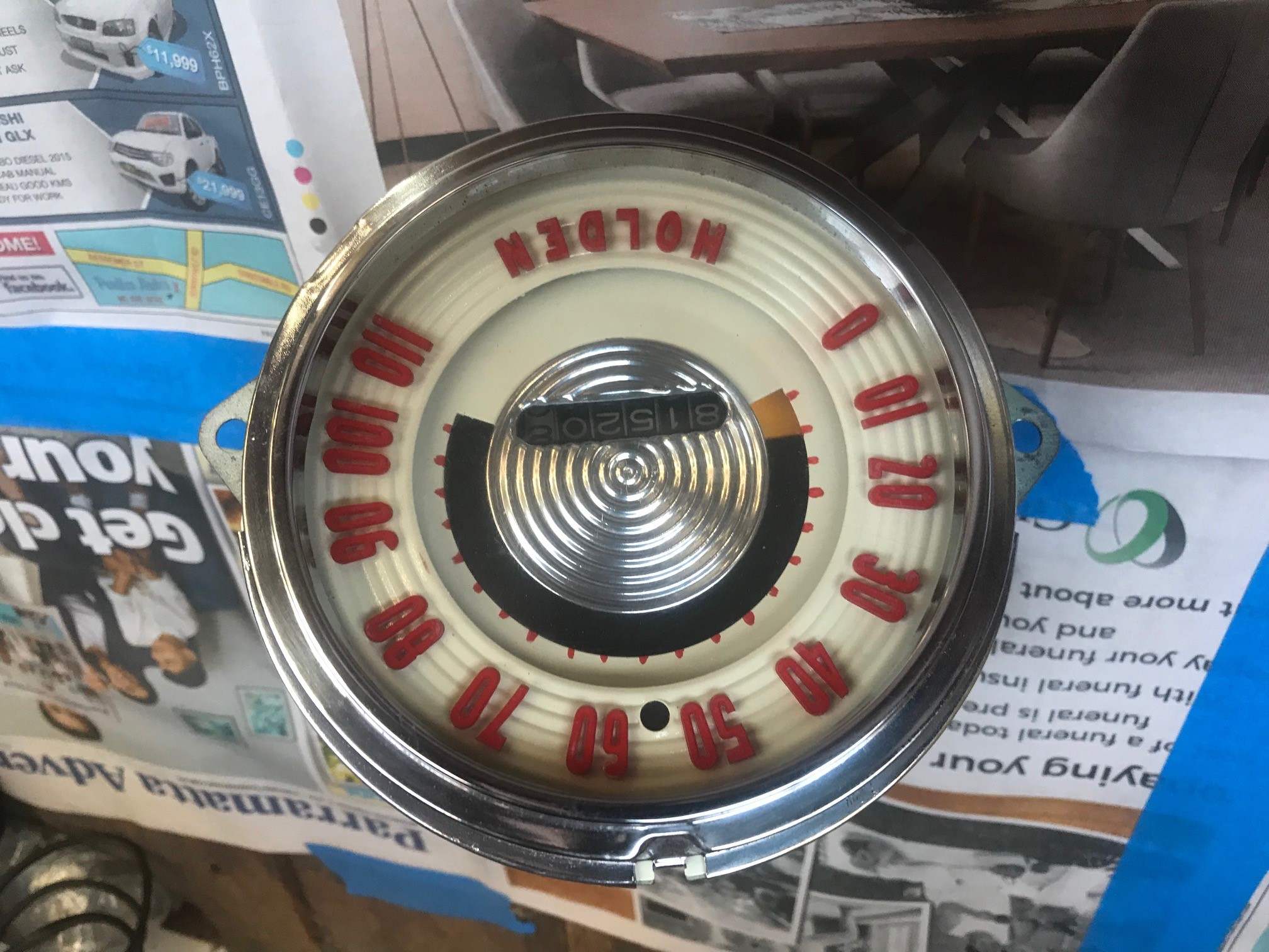

- 1272_krvLWqxsRv6ZquU8N1+CMQ.jpg (496.94 KiB) Viewed 2568 times

Take whole dash assembly out, two Phillips head screws let the speedo fall out. Prise up some of the chrome tabs around the edge of the speedo...
... and the glass and bezel falls out. Put it onto the nice clean paper that you laid on the bench to avoid marking any of the gauge face.

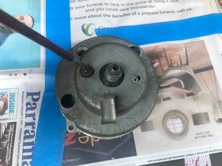

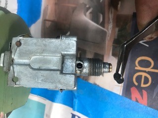

ardiesse wrote: Mon Feb 11, 2019 5:56 pm and lift the mechanism out complete. Remove the rubber gasket if it comes out with the mechanism.
ardiesse wrote: Mon Feb 11, 2019 5:56 pm The oiler is in a cross-drilled hole with a small Welch plug holding it in. Use an O-ring removing tool to get the plug out,
If you use a small medicine cup, the kids will later wonder why the medicine tastes like kero and NASCO grease residue

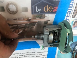

When reclaiming a busted speedo cable, keep both ends. Cut one 6" long to use with your fingers (this is handy to use with the speed in the car), and cut the other end short to go in a drill. 6" of speedo cable in a drill will tend to bow and whip around.ardiesse wrote: Mon Feb 11, 2019 5:56 pmGet your piece of busted cable, insert it in the drive end and rotate with your fingers.
Speedo feels smooth, but does not always want to go back to zero. It is sticky in there somewhere. Cheers,ardiesse wrote: Mon Feb 11, 2019 5:56 pmThe drive "should" feel smooth and slightly viscous by hand.

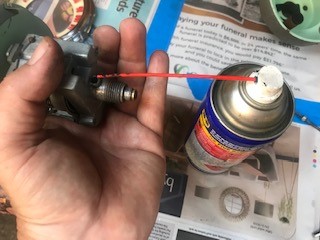

Solvent going in...ardiesse wrote: Mon Feb 11, 2019 5:56 pmyou will need to get some solvent in to dissolve the gunk, and then re-lubricate with sewing machine oil. WD-40 works well as the solvent, but it may take a day or two to free up gummy lubricant.
... and some gunk starting to come out:
Yes Master Po. I now see the great clarity that instructs your efforts.ardiesse wrote: Mon Feb 11, 2019 5:56 pmPatience, Grasshopper. Only when the speedo drive shaft feels completely free by hand should you oil the shaft.
Sadly back to work again, so the WD40 has a lot of time to work

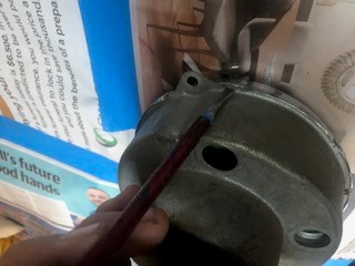

I'm guessing it is this doglegged arm, and that to adjust the taper pin you rotate the arm?ardiesse wrote: Mon Feb 11, 2019 5:56 pmInside the speedo is a "zero-adjust" which the hairspring anchors to. It looks like a metal arm projecting out from the Nikola-Tesla-rotating-magnet-eddy-current-cup-thing. It's used to set the pre-load of the hairspring when the pointer returns to the zero-stop. If you move the arm, you can vary the speedo error - but it's a uniform error, independent of road speed. So, for example, you may have to get going at 15 mph (say) before the pointer moves off the zero stop. At 30 mph indicated, the road speed is 45; at 60 indicated, you're doing 75, and so on.
The outer end of the hairspring is retained by a taper pin. If you change how many turns of the hairspring are active, you can correct for scale errors in the speedo (think y = mx + b. The zero-adjust above changes b, varying the number of active turns of the hairspring changes m). This will change how the speedometer relates to the odometer, though. I have a suspicion that most speedometers are set up so that 1000 input rpm should give 60 mph on the speedo, one mile per minute on the odometer. Let me see. 60 mph, 3000 engine rpm, times 8, divided by 23 = 1030.
There doesn't seem to be much holding it in place... perhaps lift slightly and turn?
