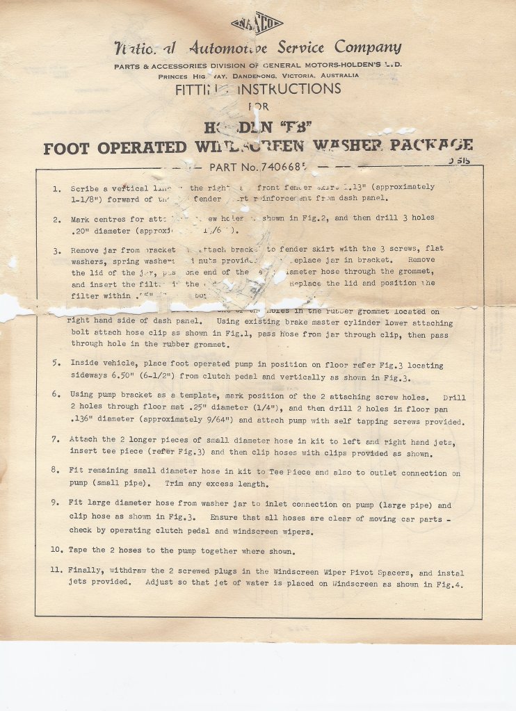

Hi All,
Wondering if anyone has detail where to mount the trico windscreen washer foot pump unit - it gets a bit busy down there on the floor with the dimmer switch and clutch but cant think of where else it would go - any assistance would be great.

pics to assist in ID
Re: TRICO FOOT PUMP MOUNTING
Posted: Tue Jan 15, 2019 12:27 pm
7406685 Foot Operated Windscreen Washer Package FB Holden 1 of 2.jpg (169.73 KiB) Viewed 555 times
7406685 Foot Operated Windscreen Washer Package FB Holden 2 of 2.jpg.jpg (199.21 KiB) Viewed 555 times
Posted: Tue Jan 15, 2019 1:07 pm
by FJWALLY
Harv - you sir are an absolute legend - thanks a million :starr: :starr: :starr: :starr: :starr:
