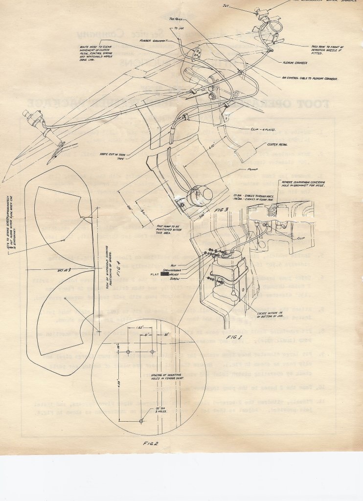

Hi All,
Wondering if anyone has detail where to mount the trico windscreen washer foot pump unit - it gets a bit busy down there on the floor with the dimmer switch and clutch but cant think of where else it would go - any assistance would be great.

pics to assist in ID
Posts: 5708
Re: TRICO FOOT PUMP MOUNTING
7406685 Foot Operated Windscreen Washer Package FB Holden 1 of 2.jpg (169.73 KiB) Viewed 553 times
7406685 Foot Operated Windscreen Washer Package FB Holden 2 of 2.jpg.jpg (199.21 KiB) Viewed 553 times

Harv - you sir are an absolute legend - thanks a million :starr: :starr: :starr: :starr: :starr:

I've been slowly stashing GMH literature away for a while. There was a bloke selling photocopies on eBay a few years back, which really crapped me. He watermarked the pages... a little rude, given it is not his copyright. Some patient work with MS-Paint and they now look as good (sometimes sharper) than the originals he was flogging copies of. A good way to while away the time after work when I am not home.
