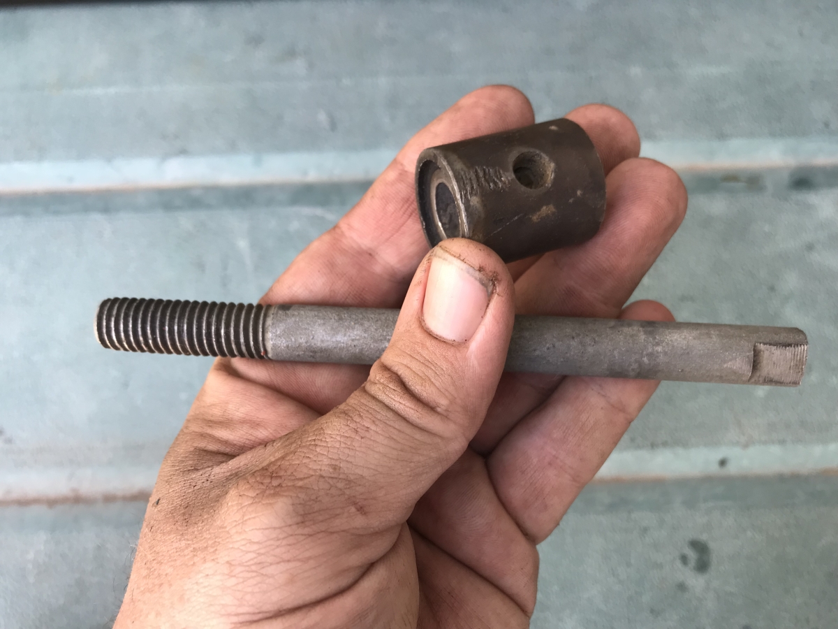

Nothing too exciting, except for the unusual shaft and fitting below:
Unusual shaft and fitting.JPG (555.04 KiB) Viewed 3529 times
Not sure if the shaft is part of this gear… looks more like a Litchfield tool.

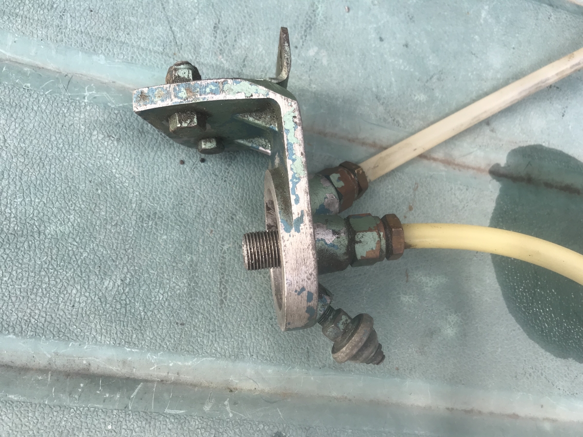

The Holden water pump gets removed from the engine, and this plate is used in it’s place. From what I understand, a small remote water pump is used to feed this fitting, driven off the same coupling pulley as the generator. The water pump has brass internals to try to cope with seawater corrosion.
Water pump replacement plate.JPG (783.25 KiB) Viewed 3528 times

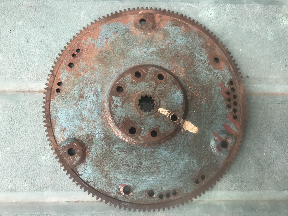

On the other end of the motor (now at the bow of the boat), a Hydramatic-type flexplate is used to engage the starter motor (no flywheel).
Flex plate.jpg (909.37 KiB) Viewed 3528 times

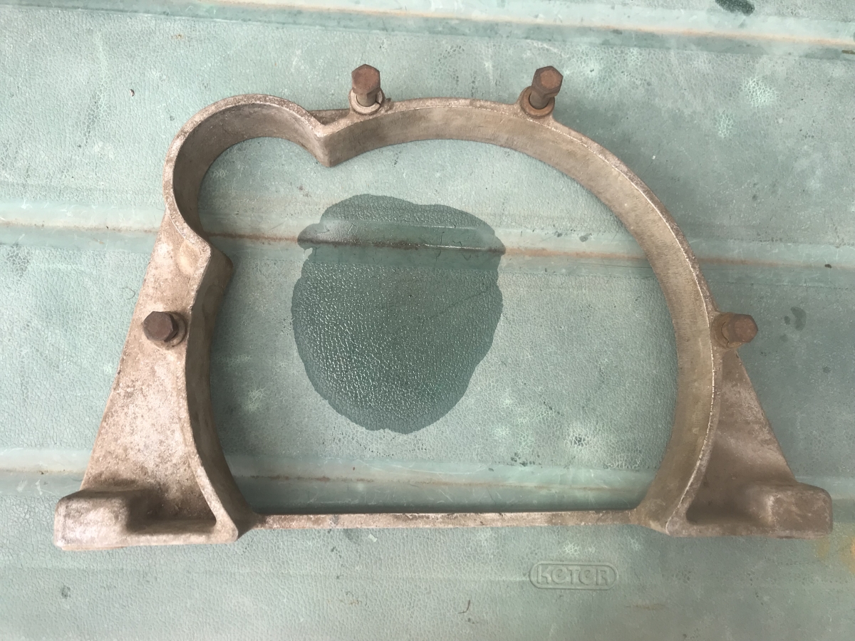

At the stern end of the boat this fitting is used to replace the timing cover. Again, two wings with large bolts either side that solid-mount the engine to the boat hull.
Timing cover.JPG (821.18 KiB) Viewed 3528 times

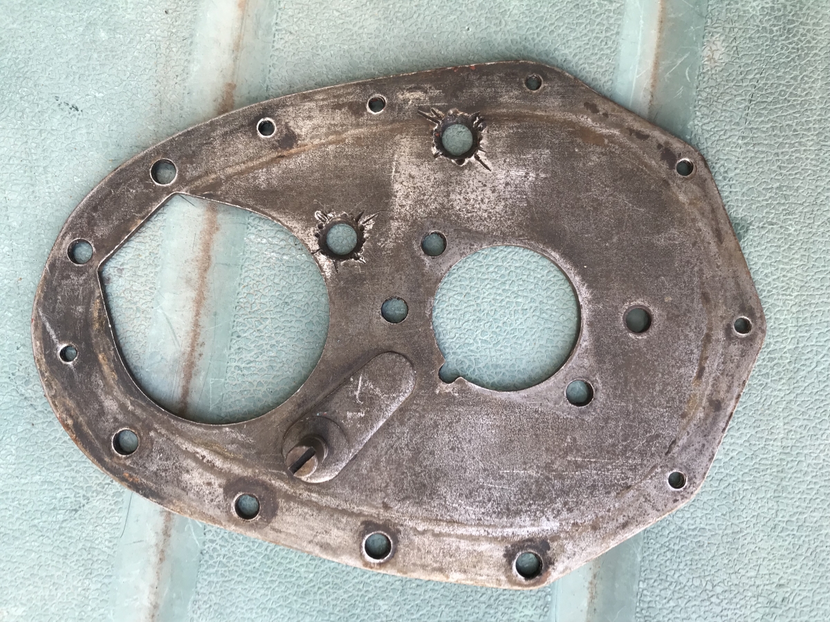

This timing cover is unusual (not standard Tawco) as it has a big hole that lines up to the end of the camshaft. The hole is used to mount a drysump pump.
Engine front cover plate.JPG (967.98 KiB) Viewed 3528 times

The gear also came with an engine front cover plate (see photo above)… nothing unusual here.

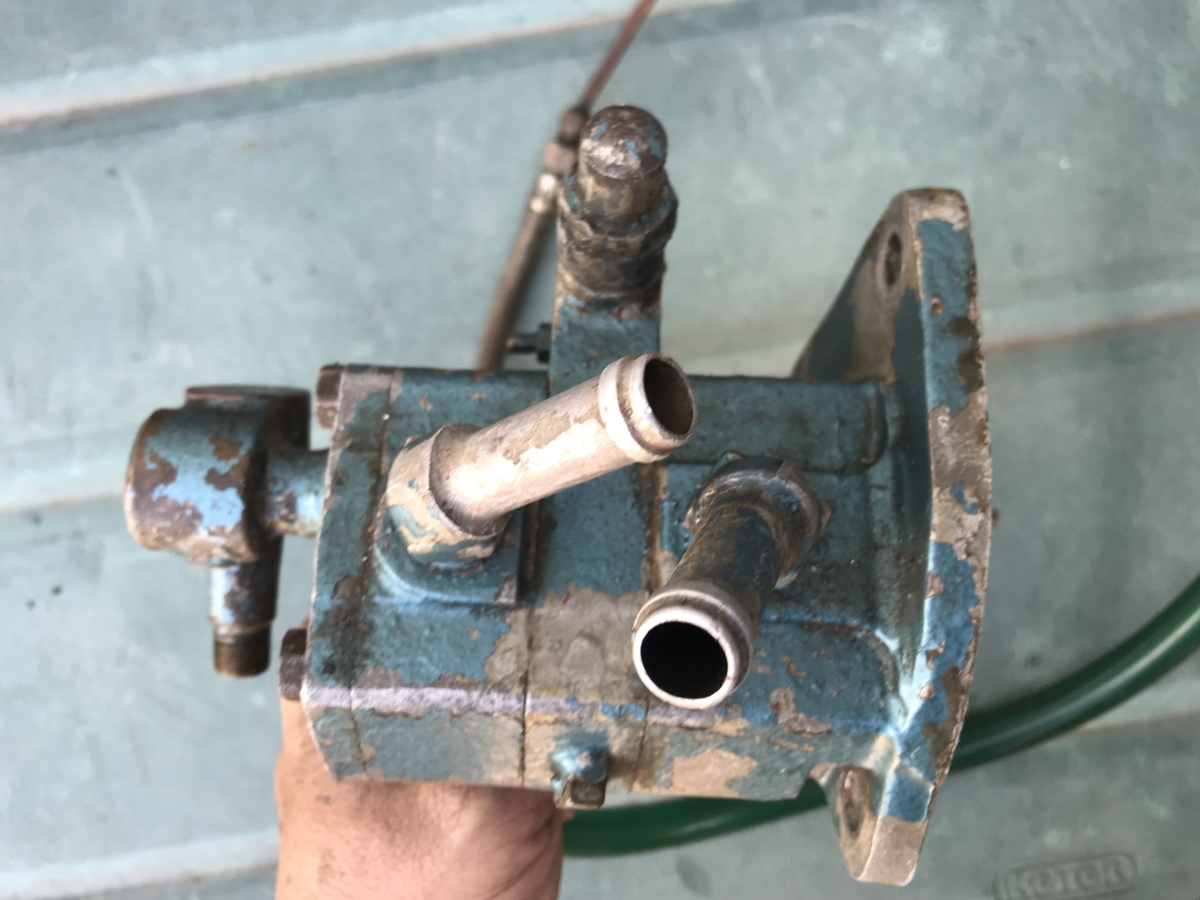

The dry sump oil pump mounts to the timing cover with three bolts. A tanged drive is used to engage a slot in the end of the camshaft.
Oil pump drive end.JPG (739.46 KiB) Viewed 3526 times

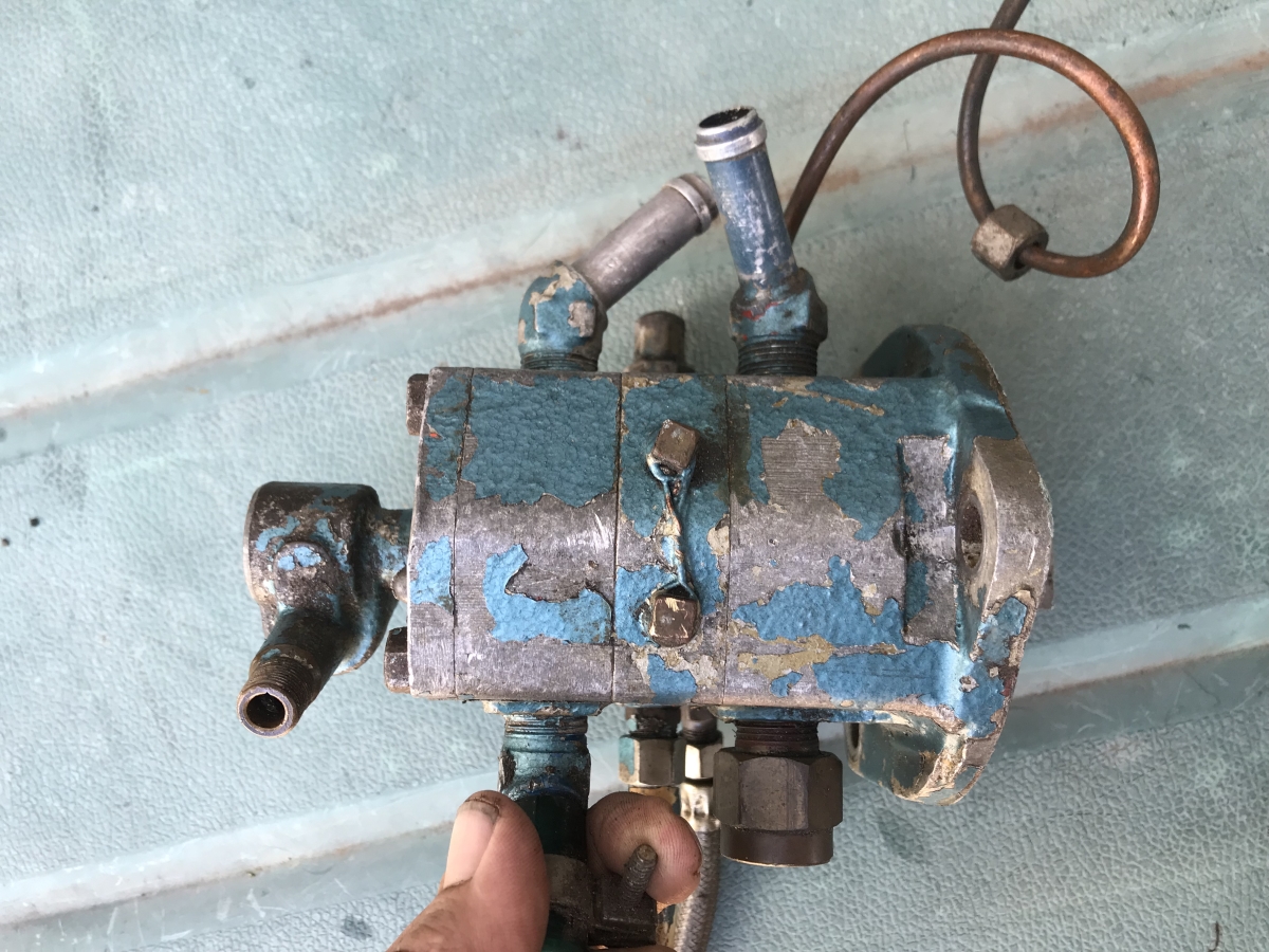

The pump is single stage. It has two ends – a scavenge end (with inlet pipe and outlet pipe), and a pressure stage (with inlet pipe and outlet pipe).
Oil pump bottom.JPG (750.22 KiB) Viewed 3526 times
Oil pump right.JPG (542.79 KiB) Viewed 3526 times
Assorted snakes.JPG (783.2 KiB) Viewed 3526 times
Posts: 5727
Re: Harv's marinised grey motor thread
I’ve got no idea who manufactured this pump, but would dearly love to know if anyone has any clues. No marking on the pump as far as I can see.
The scavenge side is set up to suck from the dry sump, and push oil to an oil storage tank. From there the pressure side of the pump takes suction, then pushes out through a filter and cooler before feeding the engine. The lineup is similar to what I have planned for the meth monster:
https://www.fxfjholden.com/forums/viewt ... ump#p54112
On the top of the oil pump is a relief valve, used to set the delivery pressure of oil back to the engine:
Oil pump front.JPG (658.77 KiB) Viewed 3526 times
One side of the relief valve has a dodgy braided hose fitted, and some copper line. The copper line is feruled to connect to an oil pressure gauge.

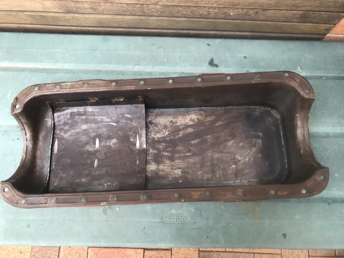

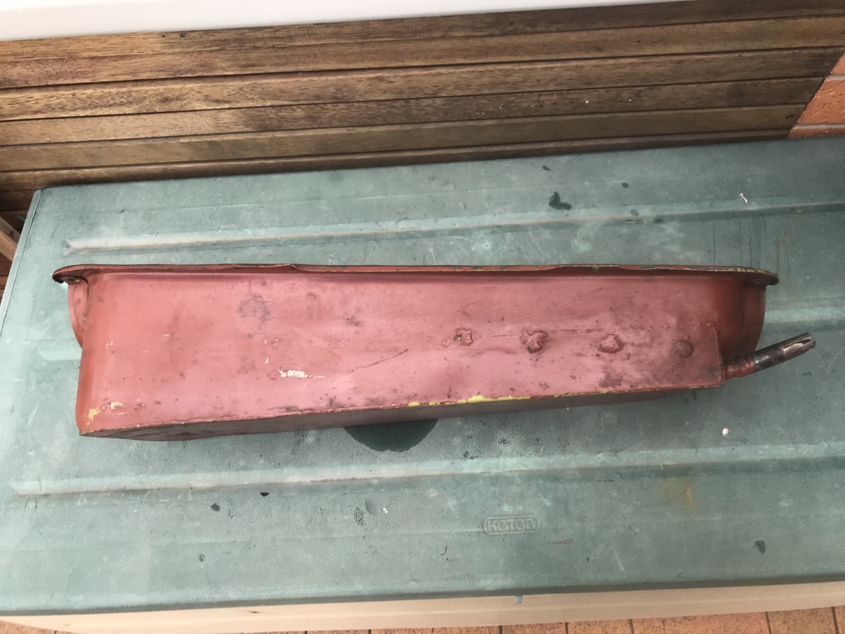

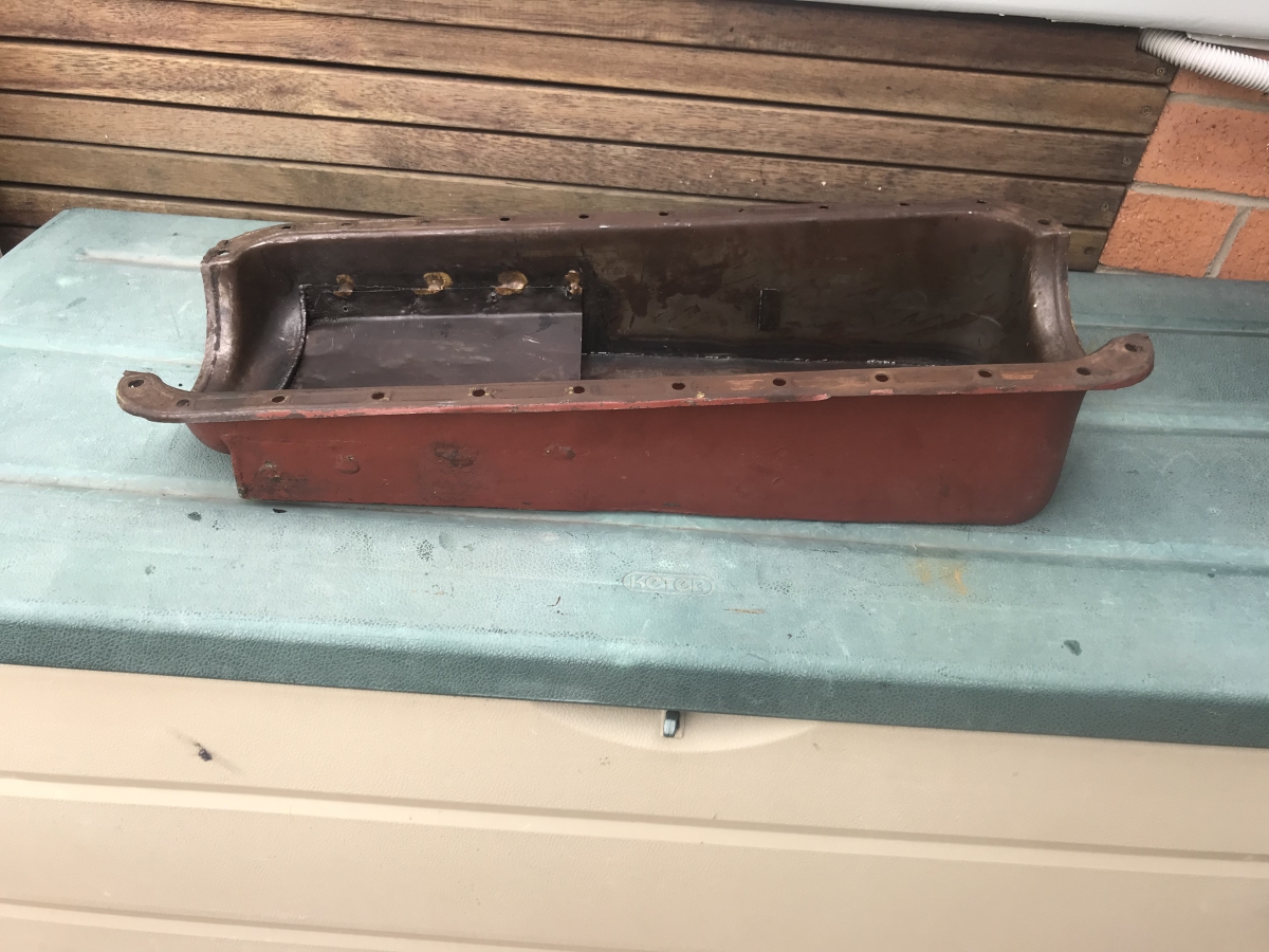

The dry sump has been made by cutting down a grey motor sump. The scavenge line connects to the bottom corner (with the engine rotated, all the oil would pool in this corner).
Dry sump.JPG (651.36 KiB) Viewed 3526 times
Dry sump side view.JPG (650.49 KiB) Viewed 3526 times
A windage tray has been brazed in place (simple steel baffle)
Dry sump windage tray.JPG (666.38 KiB) Viewed 3526 times

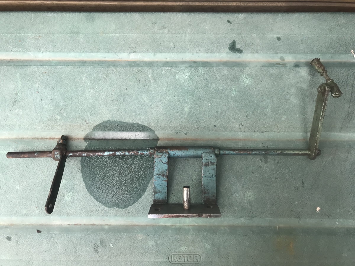

The gear also came with this cross-shaft. I suspect this is for remote dog clutch operation, but am not sure. Can remember seeing one hanging out the back of Dave’s boat a few weeks ago, but was distracted by the big block &*#@.
Cross shaft.JPG (782.34 KiB) Viewed 3526 times

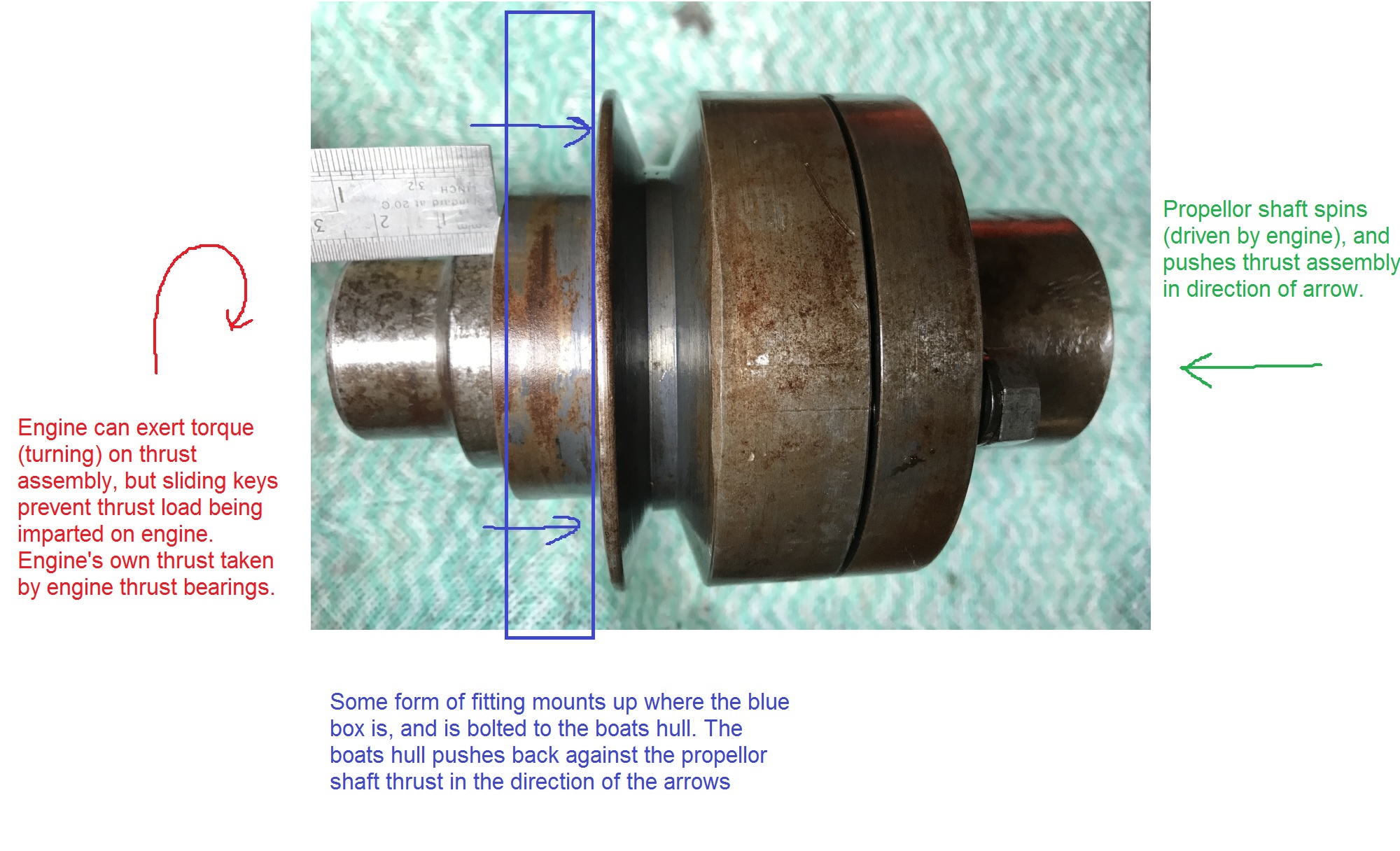

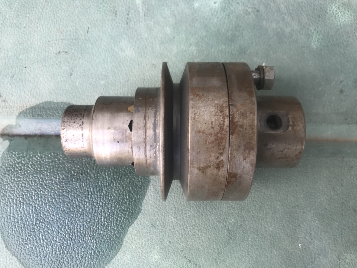

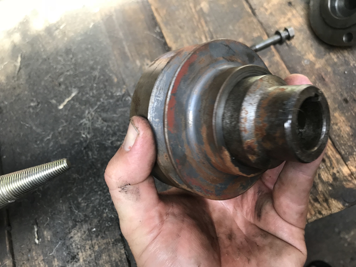

I took some time over Christmas to start to look at some of the marinised gear above. I started with the coupling. In theory this beastie connects the grey motor crank to the propeller shaft (it replaces the harmonic balancer):
The piece on the left fits onto the grey motor crank (nearly 1” diameter bore), whilst the bit on the right fits onto the prop shaft (7/8” bore).
The interesting bit is the internals. They are splined, with round keys. The cylindrical bits are not rollers – they do not spin. Instead they are keys, used to lock the crank/prop ends together.
The splined arrangement allows the crank and prop ends to move apart by 10mm (by sliding along the cylindrical keys).
The sliding could be useful in splitting the coupling, but 10mm seems very short a movement to disengage a shaft. I can understand a sliding coupling is handy – it means you don’t have to be super-accurate in prop shaft length. The weird bit though is that when you slide the coupling, the pulley groove slides too. So if you had an accessory (say generator, or water pump) hung off the block, the drive pulley/belt would slide away from the accessory.
Anyone got any ideas why these things slide?

Harv it is a thrust assembly. It has to be set up and shimmed so that all the pushing force from the propeller is taken at this point rather than at the crankshaft thrust bearings. The drawing below is a Seacraft unit.
Ideally the crank should be able to have its normal end float whilst all the propeller force is taken at the thrust housing bearing hence the sliding pins for the pulley.

Aaahh.... thanks Craig. That makes more sense. I had assume that the propeller thrust was all taken up by the engine (come to think of it, that would be one hell of a load for the engines thrust bearings).
If I understand it right, is the image below correct?
Is the "blue box" part the marinised timing cover (which has wings that bolt to the hull), or is a separate assembly used?
