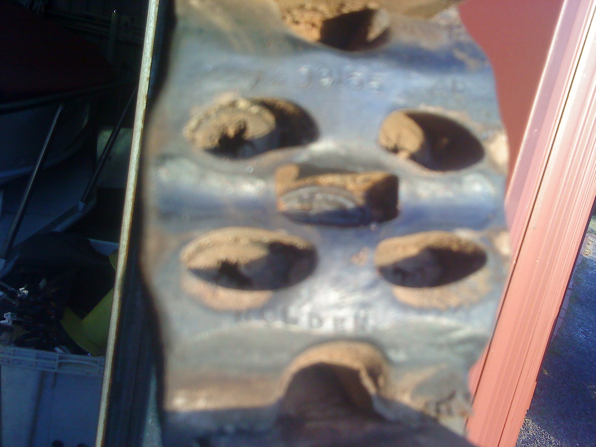

Hi,
I need to replace my outrigger insulator as it’s now more crumbly than rubbery.
It’s a two piece unit and the one sold by Rares is a one piece.
Anyone know if this is ok for my stock FB?
John

Hi John,
I'm very confident your 2 piece would have started out as a 1 piece early in its career.
That will fit fine.

I've found the same. Some were two piece.

EK283 wrote:Hi John,
That will fit fine.
I thought that might be the case Greg, but the one shown in the parts manual showed an upper and lower insulator.
I’ve just looked a bit further and found there’s also a one piece for FE-EK, though no picture shown.
So as you say, it’ll be fine. Thanks

It just goes to show that all is not what it seems !
I have had both FB and EK cars and both were 1 piece. I suppose as the FB was being developed into the more refined and superior EK Holden went with the one piece. :helleyes: :helleyes: :helleyes:

Au contraire my good man , the General was cutting costs and found it was cheaper to make a single piece figuring the EK was never going to match the style and class of its predecessor :lol: :lol: :thumbsup: :wave:

I’ve had cars with each, one and two piece.

Mate I have a brand new rubber one that I did not fit to Frank I used a Nolethane one for him so you are welcome to the rubber one if you want
:problem: Ah I will just have to find it :roll: :roll: let me know and I will dig it out. :ebiggrin:

Thanks, Neil. I’ll give you a buzz.
