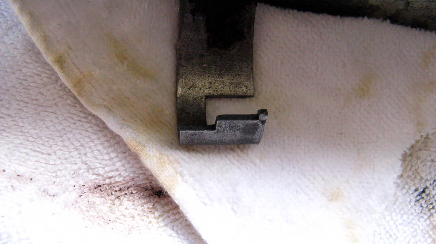

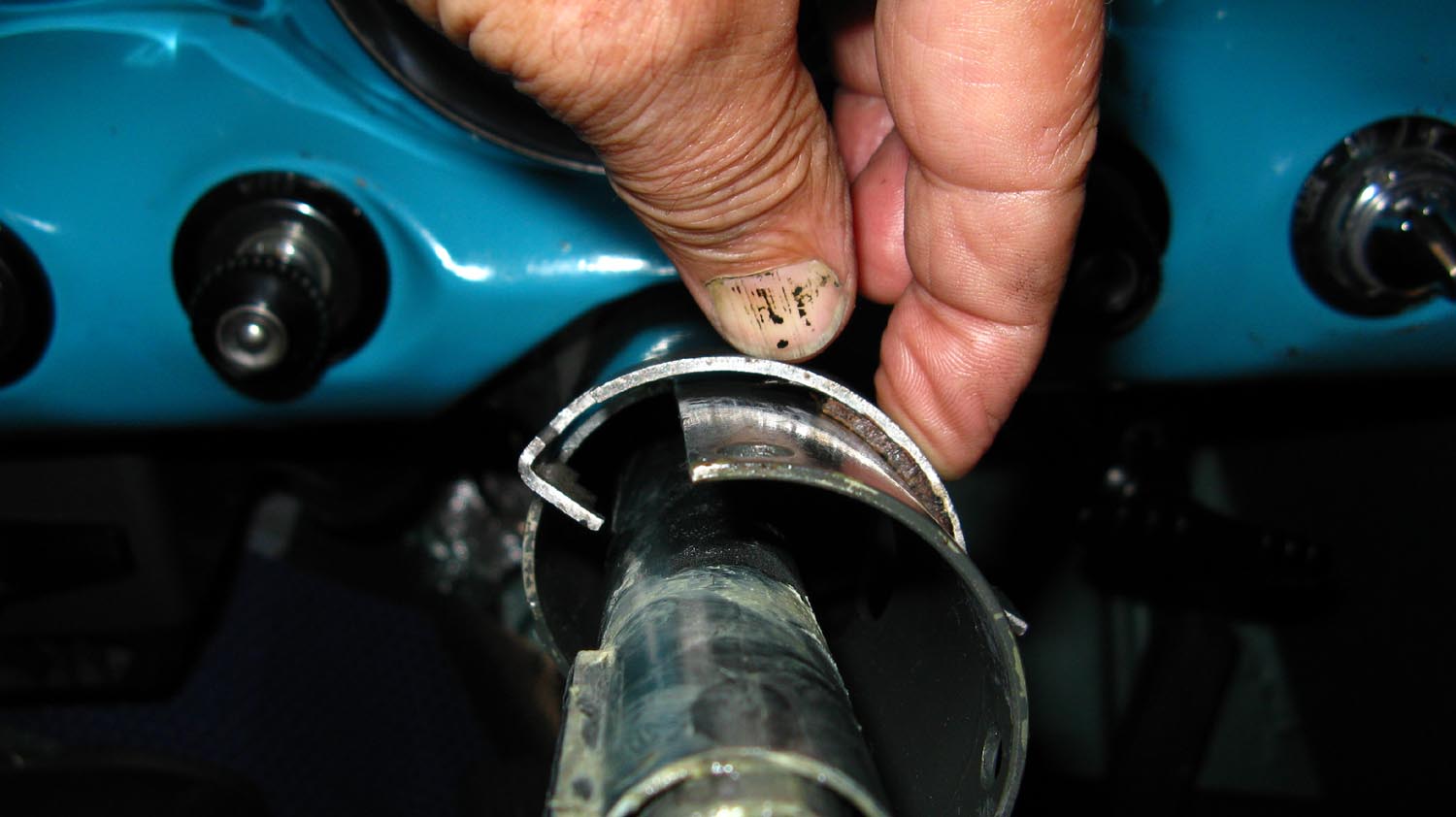

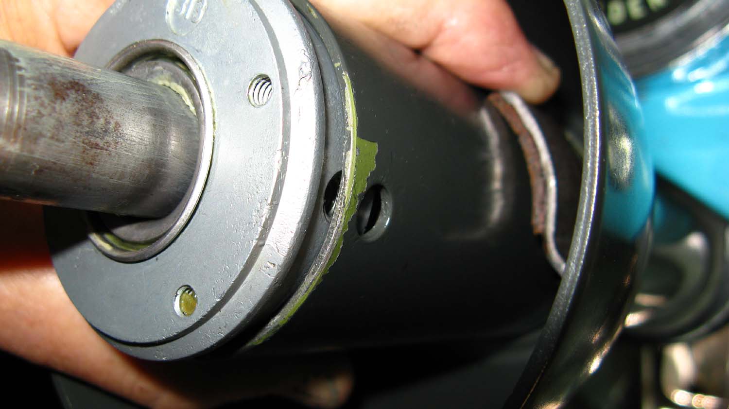

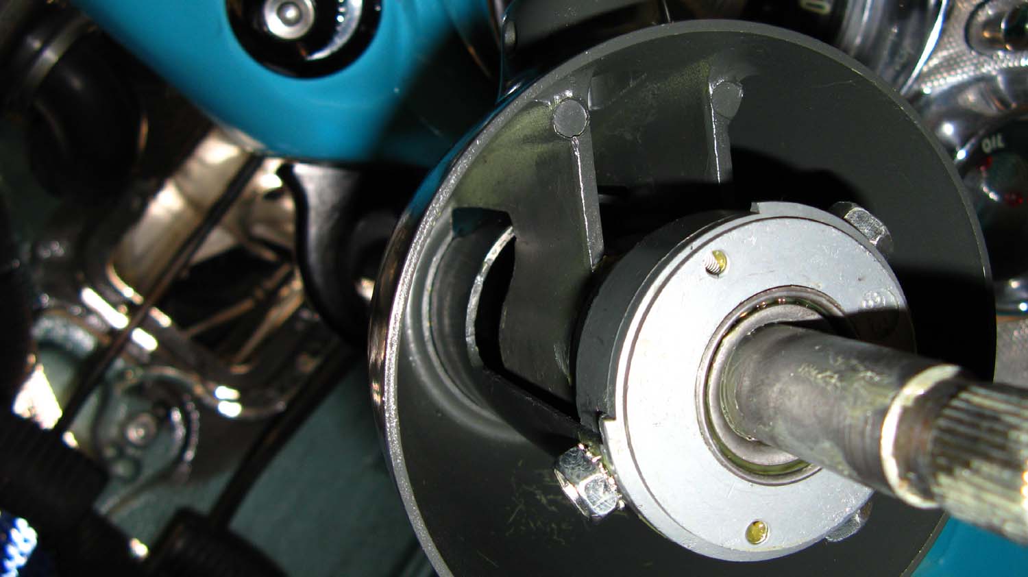

Ok folk,
series of pix here... taken due to frustration at not being able to get the dampers in "below" the honeypot.
First three are of the dampers - illustrating the special legs and cut-outs obviously made to both key into the honeypot and clear the components around the steering column..
When fitted "below" the honeypot -they actually make sense... but won't allow it to move down sufficiently for the three bearing retainer bolts to be located in the corresponding holes of the steering shaft.
Pix show all this - including one where you can see my frustration at how close the holes missed by.
The second last pic shows the honeypot fitted without the dampers and how much clearance there is between where I tried to fit the dampers and the steering column.
I'll fit these dampers today and show them in their correct position later..
Pix..
Pix..

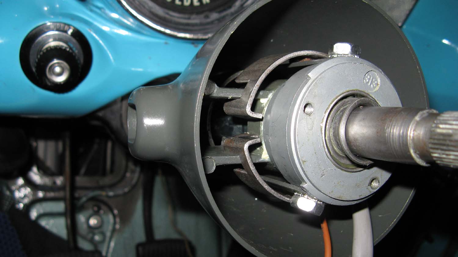

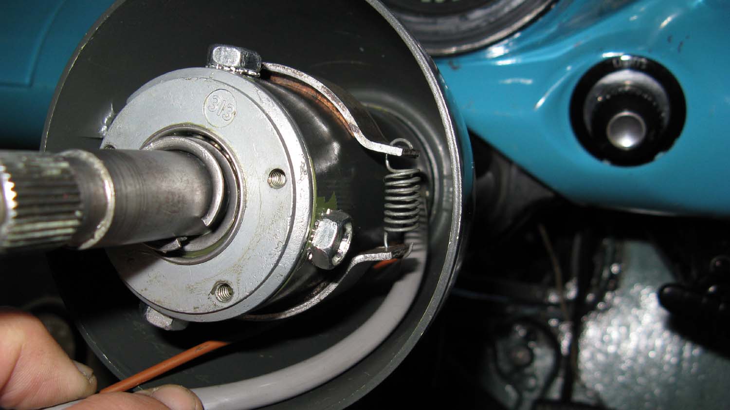

Hi folk,
promised I'd be back tonight..... dampers now in.... it took all of 10 seconds to fit the springs and fit the dampers over the steering column.... grrrrr! that's two hours from yesterday I won't get back...
Pix showing the dampers in the correct position... hopefully, this will save some of you an awful lot of frustration... just remember to alter your workshop manuals...
Pix...
Pix...
