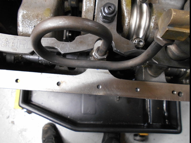

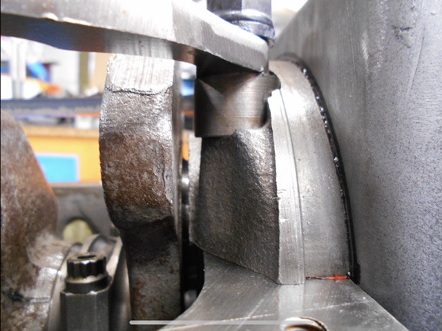

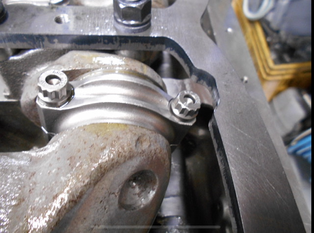

I have been planning on fitting a sonic crank girdle to the grey motor I am building but I was talking with Eddie Woods from HSD and he questioned if I really want to go down that road.
Apparently the mods required to fit it can be extensive.
Has anyone got any photos of the clearances that need machining on the girdle to clear the crank and rods?
Also when the sump is modified to give extra depth to suit the girdle, will the sump interfere with a drum brake front end or will the engine mounts need spacing up to clear the sump from the front end?

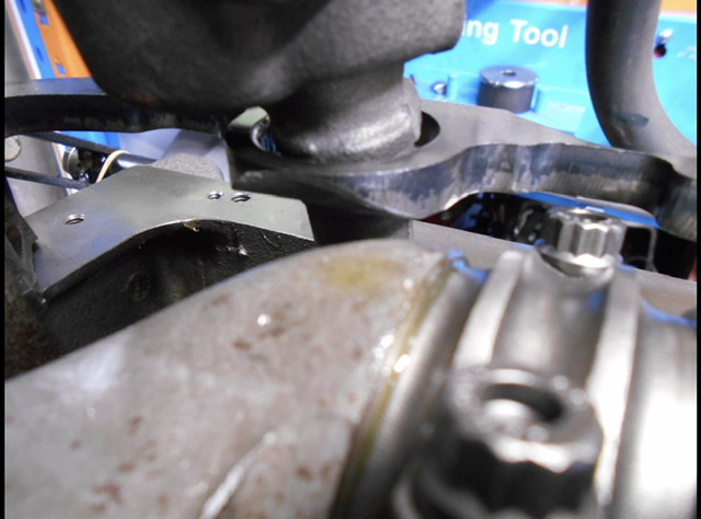

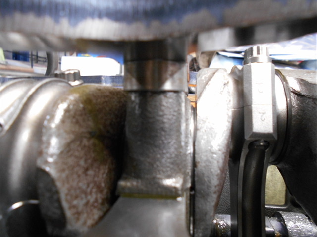

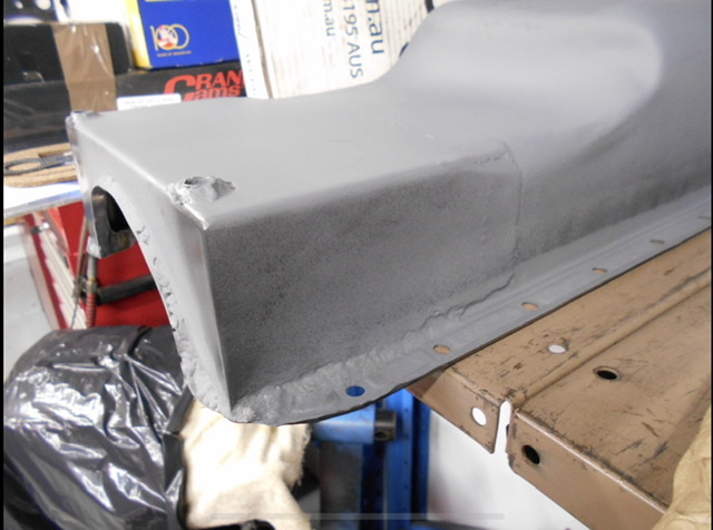

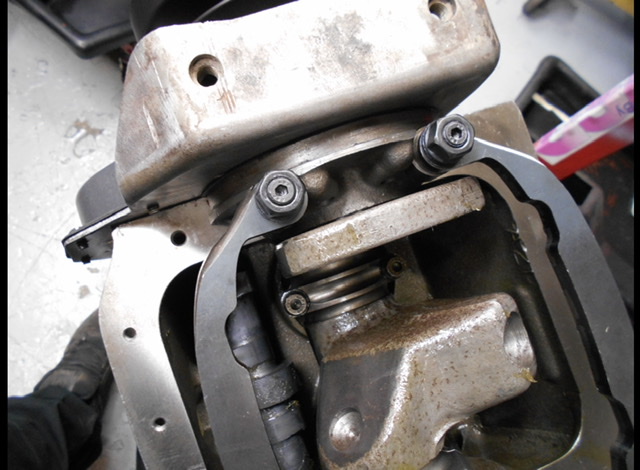

FbSTDwagon
Posts: 790
Re: Sonic Injection
Post by FbSTDwagon »
Yep I agree with all of you and I don’t need a girdle for the motor I am building, it’s really only going to be a warm motor.
I acquired so photos of the modifications required to fit the crank girdle and it has put me right off the idea.
It’s certainly a lot of work to make it all fit and I don’t want sump mods so I’ll just let it slide to the side at this point .
Photos below

FbSTDwagon
Posts: 790
Re: Sonic Injection
Photos of crank girdle mods

FbSTDwagon
Posts: 790
Re: Sonic Injection
More
Drew

Awful lot of buggerising around for precious little if any benefit on a street motor mate.
FbSTDwagon
Posts: 790
Re: Sonic Injection
Blacky wrote: Sun Sep 12, 2021 7:01 pm Awful lot of buggerising around for precious little if any benefit on a street motor mate.
I absolutely agree mate and I’m not going to go ahead with it.
Photos posted as a reference for others.
They way clearance has been cut on the girdle in places make it so thin, really not worth fitting in my situation
