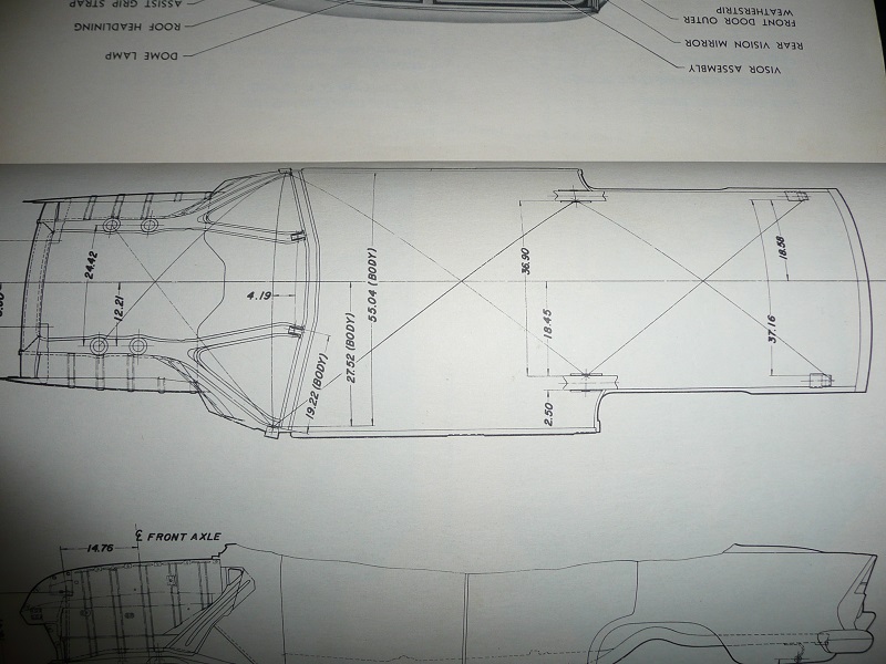

Hi Guys. Just wondering if there are any body/chassis measurements anywhere. The ute I am working on has an alignment issue in the rear. I believe I know what it is just need to confirm. A measurement from the outside of the rear spring hanger without any attachments should tell me the story.

Centre to centre on the rear spring hangers on my sedan is exactly 1 metre, I'm assuming the ute will be the same as they ran the same floor pan apart from the fuel tank and spare.

chimp wrote: Tue Jun 13, 2017 12:22 pm Hi Guys. Just wondering if there are any body/chassis measurements anywhere. The ute I am working on has an alignment issue in the rear. I believe I know what it is just need to confirm. A measurement from the outside of the rear spring hanger without any attachments should tell me the story.
Thanks
These any help to you?
Posts: 11680
Re: Rear measurements.
That's gold Phil. 25.4mm x 39.4" is 1001mm Greg.
You don't have the longitudinal measurements Phil?

Errol62 wrote: Tue Jun 13, 2017 9:56 pm That's gold Phil. 25.4mm x 39.4" is 1001mm Greg.

Hey Chimp;
There you go mate I knew somebody would jump on with the pages from the manual.
Hope it is not to far out mate and I don't f@#Kbook so can't see the pictures.

I have worked out what is wrong. I previously replaced an inner rear support panel. I put the new one where the old came from, turns it was wrong from factory. Now need to source another one or start fabricating. Because the one I fitted was MIG welded it was ruined taking it back out.
I have found the factory issue when I was removing the tray floor on the right rear. It let go with a "BANG" because it was under so much pressure. Have only had panels do that on smash work.
