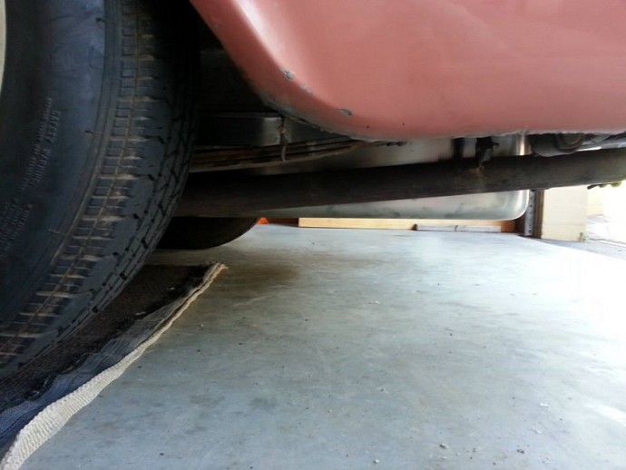

Would I be correct in assuming this tank is too low to comply with modified vehicle guide lines?

The tank in the photo is not compliant if it sits lower than the diff.

oz_ek wrote:Would I be correct in assuming this tank is too low to comply with modified vehicle guide lines?
Hard to tell without the bumpers etc in place. The tank has to have a minimum ground clearance of 100mm (anything less than 200mm has to be shielded), meet the departure angle requirement, and not hit the ground if a tyre deflates.
Departure angle is from the static loaded rear tyres to the lowest, rearmost extremity of the original GMH permanent body work - easiest way to think of it is that if you grabbed the front wheels and lifted them up (and up, and up), the rear bodywork hits the ground before the fuel tank does.

The tank in that pic looks compliant Phil. What is it mate?

Errol62 wrote:The tank in that pic looks compliant Phil. What is it mate?
Clay the tank in the pic is one of Martin Dean's (M&C Dean Fabrications) stainless steel tanks, the one pictured is at least, if not more than 50mm deeper than standard.
