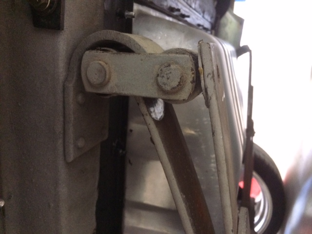

Firstly, here is a pic of how my shackles were before I started:
Shackle down.JPG (79.18 KiB) Viewed 4772 times
I proceeded to flip the shackle and the second leaf caught underneath the shackle as pictured. i'm not a terribly bright spark, but I did figure this was wrong.
First flip shackle.JPG (80.66 KiB) Viewed 4772 times
So after a lot of swearing, jacking, pulling and banging - not necessarily in that order - I managed to get the second leaf inside the shackle.;

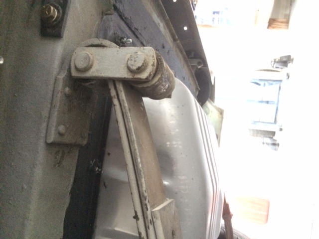

Final shackle.JPG (80.57 KiB) Viewed 4772 times
So, my queries are: Does the collective mind on here agree that this is the correct position for the rear hanger and the leaf springs?

Those springs look like the wrong ones to me - too long ????

Definitely the wrong springs. Too long as Blacky said. The second leaf is also too long compared to standard. With a fully loaded car and flat springs the shackle should not be in contact with the mount. Check page 4-27 of the Workshop manual if you have one figure 4C-5. Length between eye centres should be 48" (19in. front, 29in rear).

I guess someone thought putting in EH - HR springs was a good idea at some point. Thanks for adding your pic, it makes sense now. I had a hand drawn sketch that I couldnt make sense why the shackle was showing parallel to the ground. It didnt show the full picture but that clears it up.
