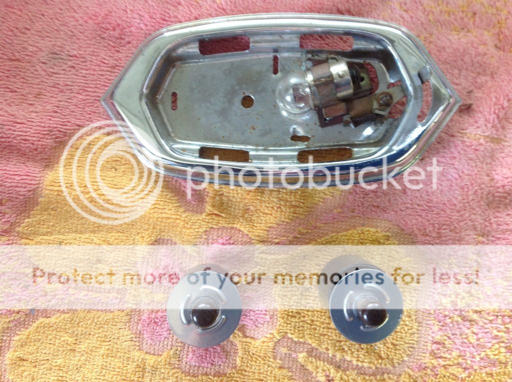

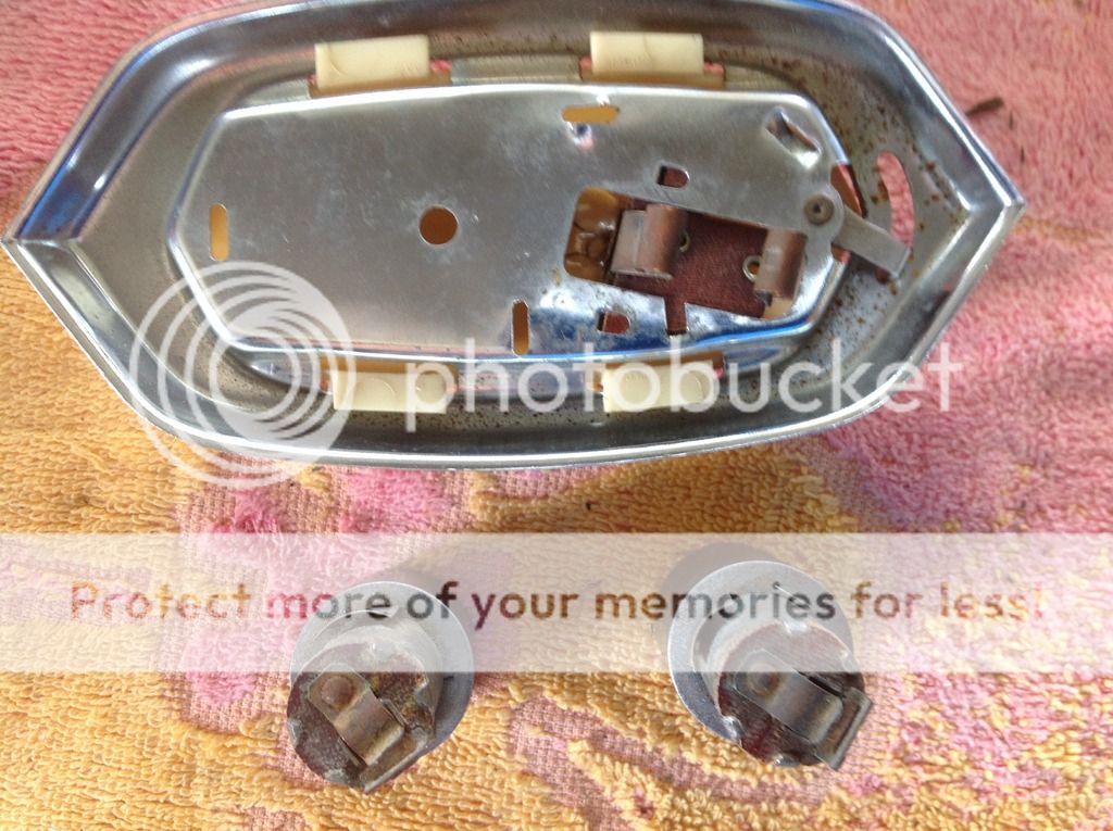

It does help but my switches only have one connection on both of them I am sure that they are original
this is what I have
And while I have you how many screws hold the light up as it only looks like one hole and it is going to be a bitch to find the holes through the hood lining at best
BILLY :arrow:

Should be two wires going up
- the orange one from the fuse panel up to the light, which provides +12V.
- the white one from the light back down the pillars to the door switches. This puts +12V into the back of the switches. When the door opens, the switches earth through their steel bodies.
From memory, doesn't the dome light attach with two twisty metal tangs that are part of the roof brace metal?

The switches are correct. I should have said the wiring for the right hand side is piggybacked to feed (earth connect) for the left.
I'll have to check when I get home next week but I don't remember screws. I think it had bend over tabs in the three slots

Yep tabs

If the car has had the light body off a few times the tabs can eventually fail. Self tappers do the job but don't drill through the roof skin!
