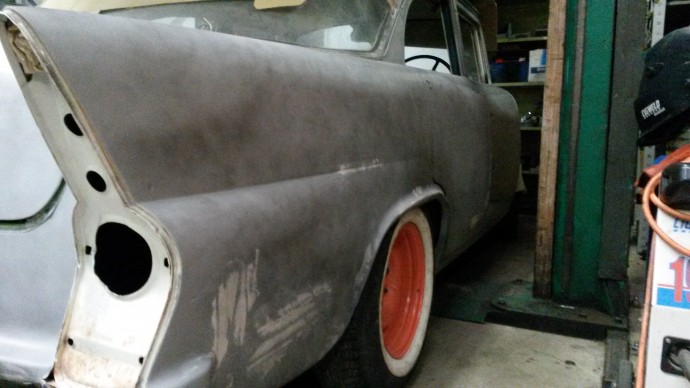

I have reversed 7"rims on my ute with a stock front end and Torana diff and have no clearance issues but the increased scrub radius makes it heavy to steer- but they are 13" , Trevs (now Oli's) wagon looked the goods and I have thought about converting to 14" to get the same look.

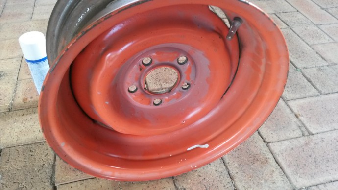

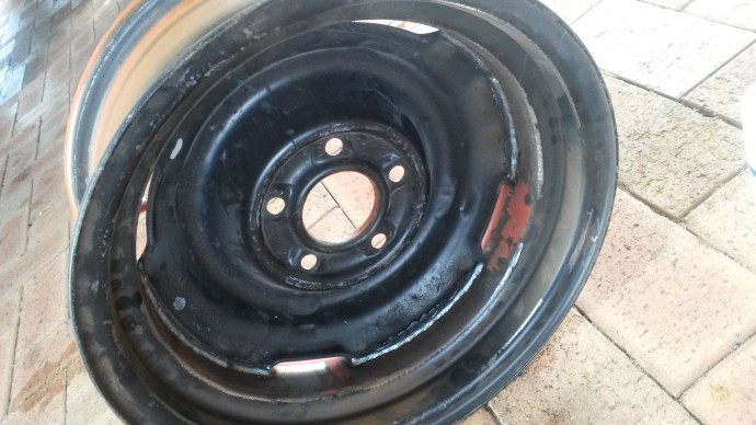

If you can find one, i was looking for one to go down this path but with no luck had the rims pulled in 30mm,Vehicle still to lowered some more.Trev wrote:To get any kind of dish on the rear you should start with a LJ Torana rear end.EssCee wrote:Hi Guys,
