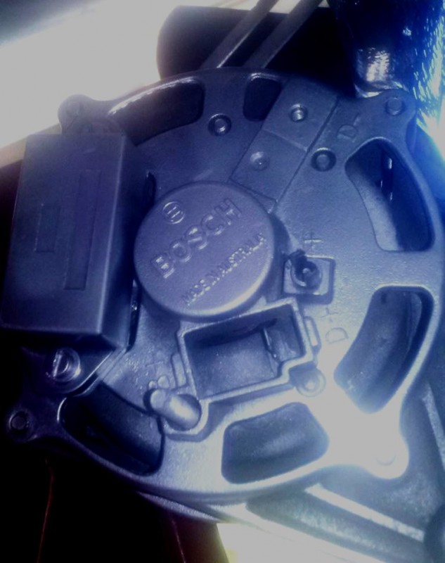

Straight to the point.......I have wired the engine up to start as if its out of the car as it has no harness or proper ignition switch, I am using a simple on/off switch as a starter switch.
Batt Neg to eng block
Batt Pos to Solenoid terminal
Starter Terminal to Batt Pos with on/off switch in line as the starter switch
Coil Pos to Batt Pos
Distributor (Pertronix) Neg and Pos to Coil Neg and Pos
In order to preserve battery life when periodically starting the engine, how do I wire my BOSCH 55 Amp alternator into the setup above?
ALTERNATOR WIRING (NO HARNESS INSTALLED)
- CAM00540.jpg (80.06 KiB) Viewed 1204 times
Re: ALTERNATOR WIRING (NO HARNESS INSTALLED)
Funny, I just got done kicking mine in the guts on a stand. Ears are still ringing.
I wouldn't bother wiring in the alternator.
Most of the time when you kick it in the guts, it will take a fair amount out of the battery. You might get six or so starts, depending on how cantankerous it wants to be. Most of the time running (on the stands) is spent at idle, with the alternator putting out bugger-all if anything. Unless you intend running it for a fair while at decent revs, you won't charge the battery.
Invest in a trickle charger, charge the battery when your done with it then take it off charge and leave it sitting there ready to go for next time (no need to leave it permanently on charge). Alternatively, swap the battery into your daily after you are done. Another alternative is to just jump it off your daily.
