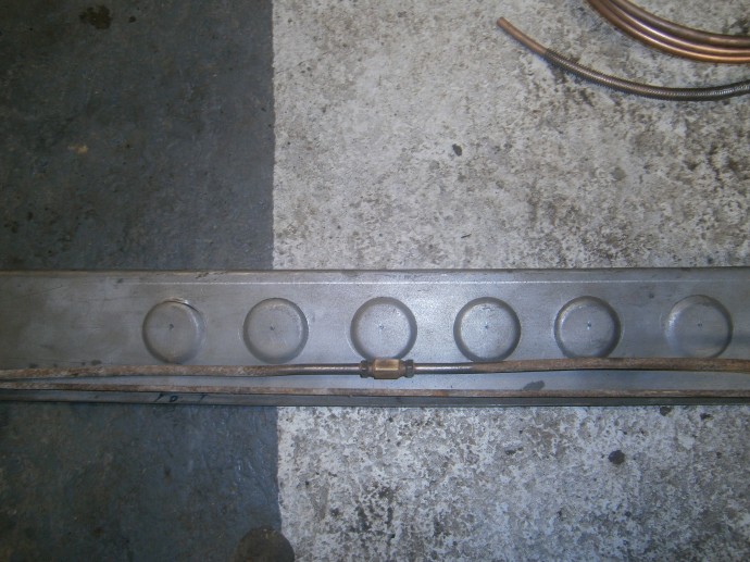

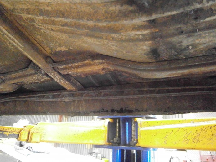

Re: braided fuel line
hi coll
"Mildred " isnt at the shop at present so heers something i prepared today
this pic is of my rusty fb ute and shows the fuel line in place around the centre of the car on the Right Hand Side with the brake line to the rear brakes running alongside it the second pic shows the joiner much more gooder like with the dirt buffed off and sitting in place on a replacment inner sill i make
also take note the roll of new 5/16 bundy pipe in the top corner of the pic(you may need it)
remove both fuel lines from car
buff dirt off along entire length of both pipes ensuring the stone guard spring moves freely.
(if the pipe is suspect have a new one made instead of X$^^*around with rusty crap)
refit to car temporary like,and mark with paint the side of the pipes facing the drive shaft.
Cut the flare off the joiner ends of both pipes and fit new metric flare nuts(duno the sise right now 12/1.5 maybee??)
re flare the pipe and using the stone guard spring gently bend the pipes out to alow clearance against the sill for the filter(30mm). This will also shorten the pipes to alow for the length of the filter.
if you marked the drive shaft side of the pipe youl know witch way to bend it and the spring will stop the pipe colapsing.
if it kinks or colapses it was stuffed annyhow.Dont remove the clips from the inner sill as thayl break
and when trial fitting ensure no pipe is under tension/compresion as this will cause the pipe to fracture later on
make a sadle to cary the filter and screw to inner sill.
Yeah i know thers a bit in it, but it will be so nice not to see those ugly plastic filters in the engine bay.
also the origional braided fuel hoses do suffer from artery disease just like me! so check for blockages and also
When was the fuel pump overhauled as leaking /worn valves/diaphragm wont ensure a good suply of life giving fluid to your grey
just like me!
i think the filter was a ryco z373 but cant be shure ive had more than one port since i did this job
I can make up the pipes and suply ready to fit but need the old stone guard springs for origionality otherwise ill fit rubber tube over the pipe to protect it
BUT this MAY CAUSE engine earth problems to the right side
Cheers The Platinum Man
one of newtons laws was EVERY ACTION HAS AN EQUAL AND OPOSIT REACTION
so the more time you spend on your fuel system
means
less time putting fuel in
better economy ??

- P1150003.JPG (100.57 KiB) Viewed 4028 times
platinum man
thanks for the pics and discription on how to do the job,
i will set aside a weekend and do the job
thanks again help and guidance is much appreciated
col
col
