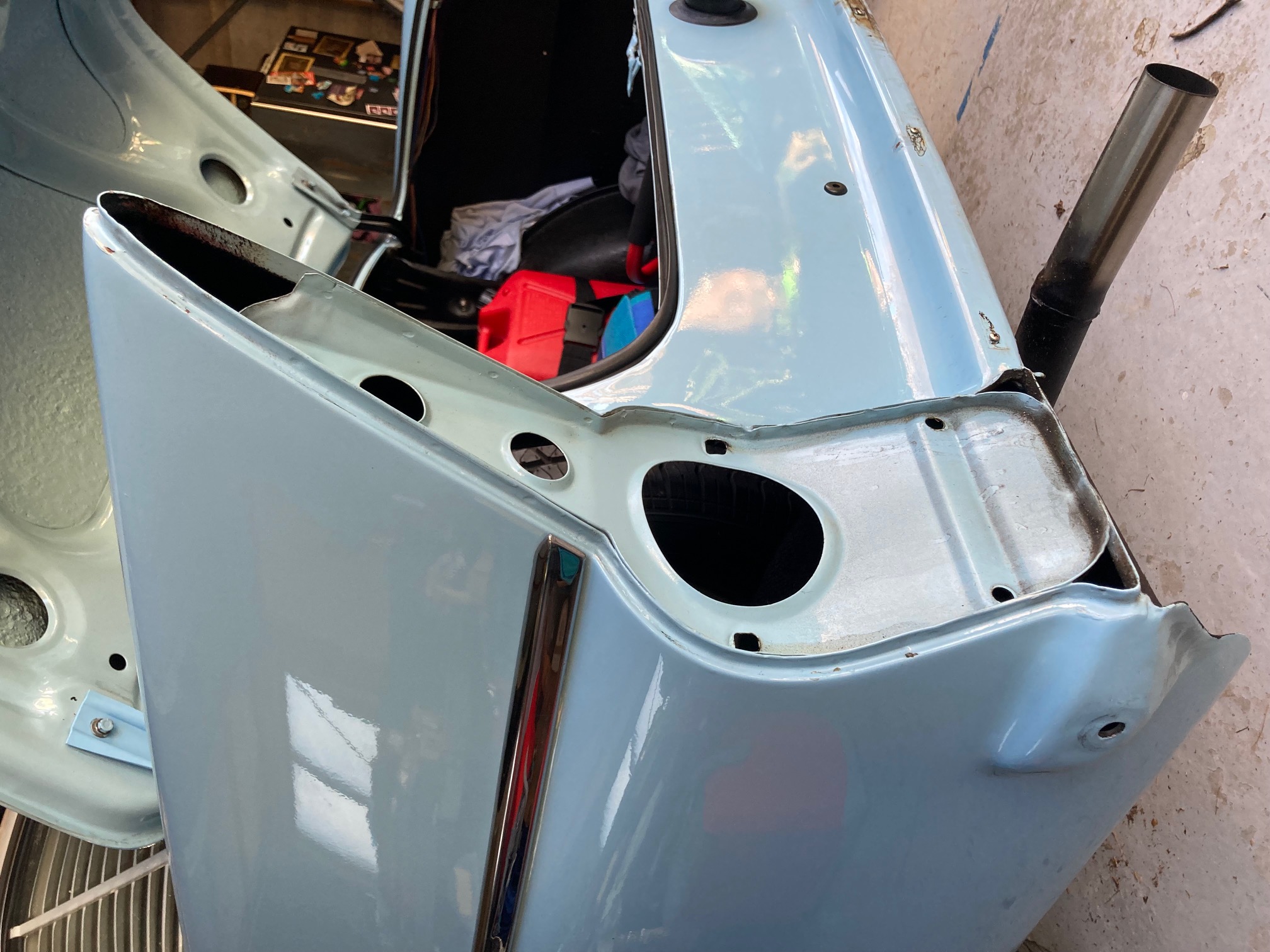

Hi,
I've go some butyl mastic ready to seal up the newly chromed tail lights, but I can't work out whether or not to run a bead along the very bottom lip. Does anyone have any thoughts on whether to just seal the sides? The way I figure it, if water gets in through the dust seal holes it might escape between the bottom of the tail light assembly and the lower lip. But then I worried about stuff flicking up from the road, and maybe I need to seal the lower part to stop that getting in?

Re: tail light sealing
Posted: Sat Sep 10, 2022 5:05 pm
by gpi
way over thinking it. if you have to: bead all the way around and in between the taillight and indicator housings.
Posted: Sat Sep 10, 2022 5:57 pm
Run the bead all the way around.
Get the stuff everywhere… your hands, the driveway, all over the caulking gun, and at least one painted surface.
Use some kero on a rag to clean it up, and smooth the bits that ooze out of the joint as you tighten the taillights.
Run out of rags, and curse the mastic.
Least, that’s what I do 🤪
Posted: Sat Sep 10, 2022 6:08 pm
Factory used a latex gasket originally that sealed around the entire edge.
Posted: Sat Sep 10, 2022 10:59 pm
by Rev Tex
Thanks guys.
And yep - if something needs to be overthunk - I'm your man.
BTW - I have a couple of tubes of black mastic that I bought a while back, but contacted Selleys to see why you can't get the grey stuff - it turns out there's a global drought of ingredients and they've ceased production of butyl mastic for the moment.
