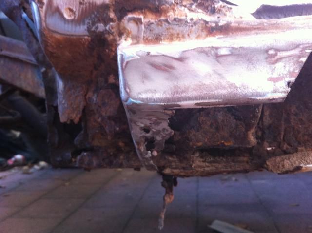

So far have. both sills, floor, rear quarters and bits of the inner sill. and 2 big holes at the B pillar and the bracing underneath them( have no idea how to do this???)

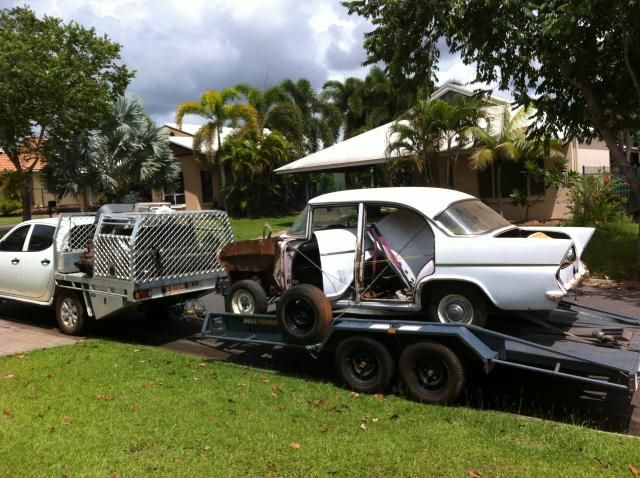

The start,
The move..

The bit im worried about..
Any comments or help appreciated.

Rust in all the usual places. Still not too bad. Mine was similar. Spend some time going through some of the build threads in members rides. It'll give you a good idea on how to tackle the repairs.
Re: Slow EK rat.
Welcome to the Forum Mick. Everything is possible. Do one area at a time. Start with the pans. The underfloor bracing you might have to get some donor sections or new sections made up.

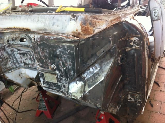

Little more done today finally got front subframe off and started cleaning up the firewall getting all that 50 year old deadener off it.

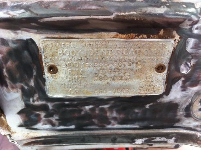

Can any one decipher the plate for me and possibly give me a year model.
Posts: 14282
Re: Slow EK rat.
Its an Adelaide built car , and is Parisian Lilac , I cant read the tag well enough to see the trim numbers ????
d1ll1g4f
Posts: 44
Joined: Mon Apr 28, 2014 11:08 pm
Re: Slow EK rat.
Post by d1ll1g4f »
Looks like 976 for the trim which is Armada Grey.

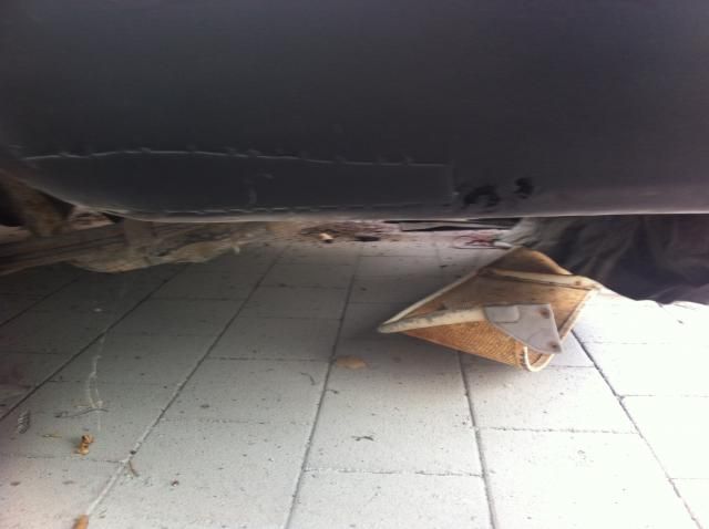

Been fixing the bits i can. Fuel tank out and started coating the boot in KBS rust seal. im going to do underbody and floors in it as well.
Few holes on the rear screen..

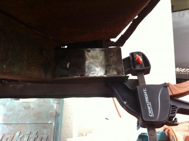

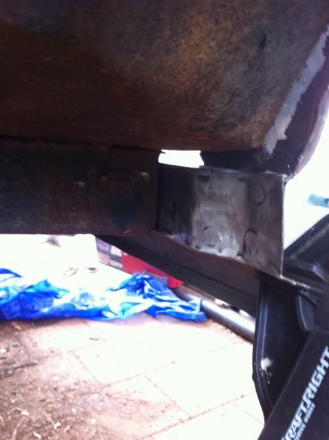

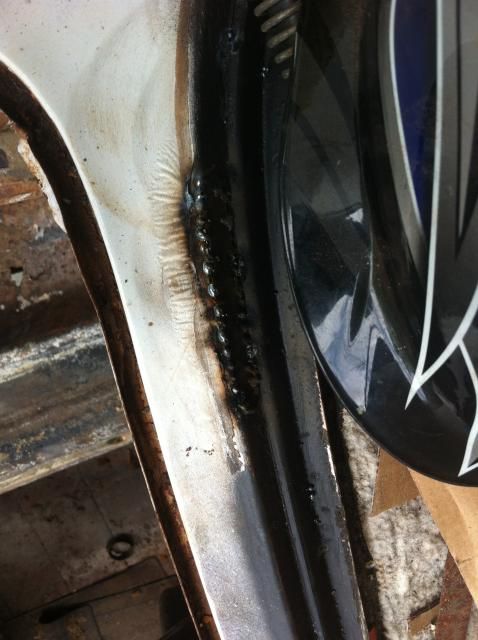

Started on the A pillar. just trying to keep it simple will probly run a crush tube through the middle tho just to keep it all together.

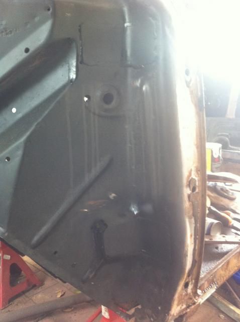

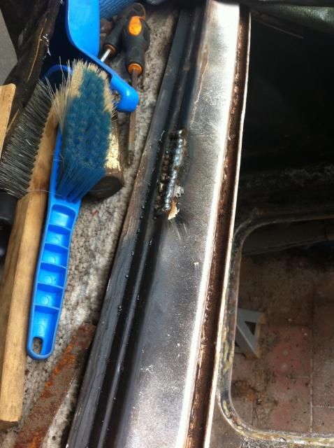

Little more done before back to work. Uncovered these littel spots while wire brushing the other day.. a lot more involved than i first thought..

Do a bit of pigging mick??
