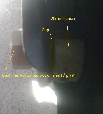

2. place spacer as per picture (Is the spacer distance for upper and lower 20mm?)
3. Place bushe in control arm screw into arm and onto pivot until any space is given up and contact made with the spacer.
4. Remove spacer
5. Attempt to torque, but my bushes keep on going on, which in turn narrows the gap between the control arm when I try to attempt it again.

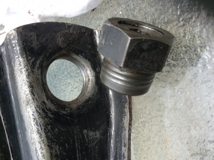

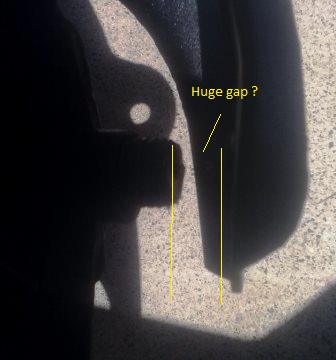

I go to set one side of the control arm and I notice the other side has come off the pivot all together with a good 10mm gap from the end of the pivot to where the control arm hole should be placed to begin installing the bush. This is why I ask is the spacer the same size for the bottom bush installation.
I am thinking if my bushes do not torque off after removing the spacer I will weld. Sick of buying replacements!

LOWER ARM - Attempt to set with 20mm spacer / bush bottoms out on pivot shaft
LOWER ARM - Notice the huge gap
Is this 20mm?
Is this 20mm?
Is this spacer 20mm too?

Ok Lex, the pictures help a lot.
Your upper control arms are stuffed if the bushes keep turning (Threaded eyes are stripped out by the sounds of it).
If your lower control arm bushes keep turning and don't get to the correct tension then they are too.
From memory I think the two spacer dimensions are different. I'm not sure, I don't have my books at hand as I'm packing to move. Do you have a workshop manual (original GM) as it would detail two different tool part numbers in the special tools list at the end of the suspension section.
Either way you don't need the spacers. I did mine using a vernier. I set the arm on the pivots equal distance then started the bush on the pivot till it just started to touch the arm. Do the same with the other bush. Once both are started then thread them all the way once they index into the arm (A little on each side at a time whilst checking as you go). Don't tension when bottomed yet, check your distances on both sides and depth to the pivot through the grease nipple hole in the bush. If all looks good tension (hopefully though tighten ok). You may have to set the bushes a couple of times to get the hole lot central. I would not weld to the control arm!
Hope this helps.

The lower spacer is 3A6 and is 38mm wide not 20mm
Hope this helps

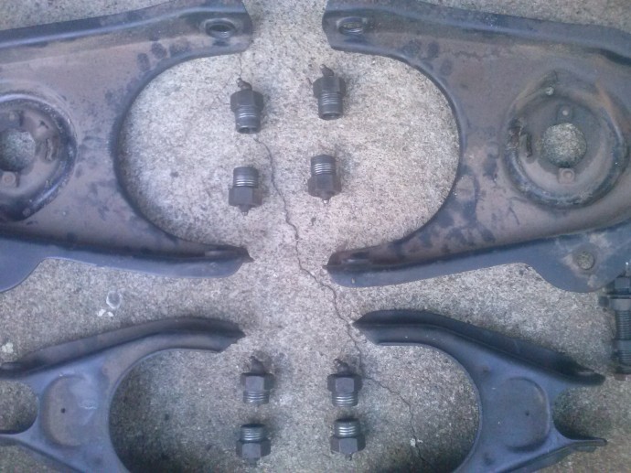

Hi everyone,
I've just taken apart the front end and found that pretty much all inner shafts have stripped threads on the support arms.
Just adding on to the above post.
I haven't found any oversized bushes to rethread for. Has anyone else solved this problem with a helicoil or will this take too much material out?
Best bet to find replacement support arms?
Thanks in advance

Tim don't panick on this just yet. I'm not sure but where they loose when you removed them? They never look like they have a lot of thread on them from the start. Screw the bush back in to the arm and if it tensions up you're ok. I'd do this when you're at reassembly stage.
Don't do a dry run before that. Each time they are tensioned you loose a little meat till they eventually do strip out.

They were on fairly tight to begin with, soaked them for a while prior to try to avoid stripping anything.
A couple seem worn more than the others, I've picked up another front end with better threads and will see how it all goes back together.
