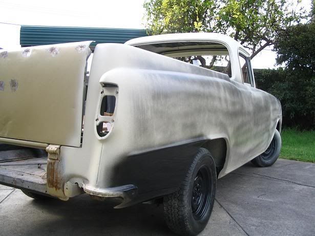

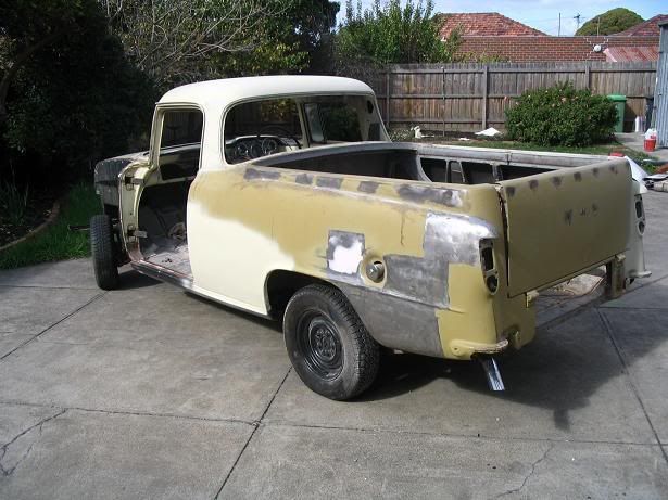

Havent posted any pictures for a long time so thought i better update on the progress of the ute what went from a quick restore changed to a detailed restoration.

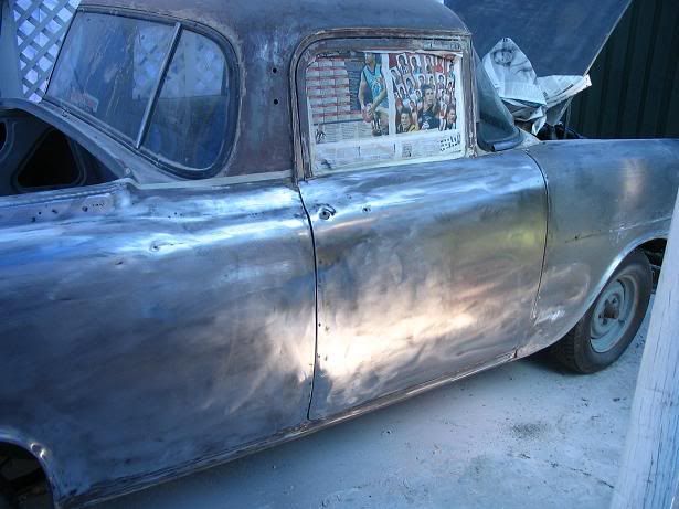

The ute was paint striped to bare metal love the shinny look

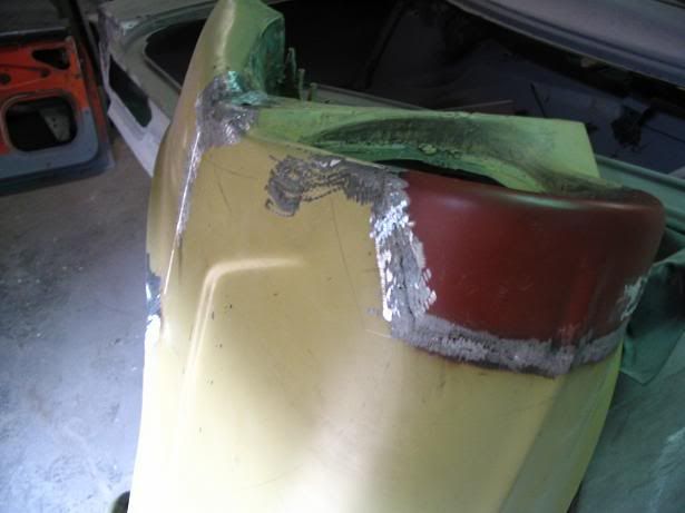

Sprayed in Etch primer

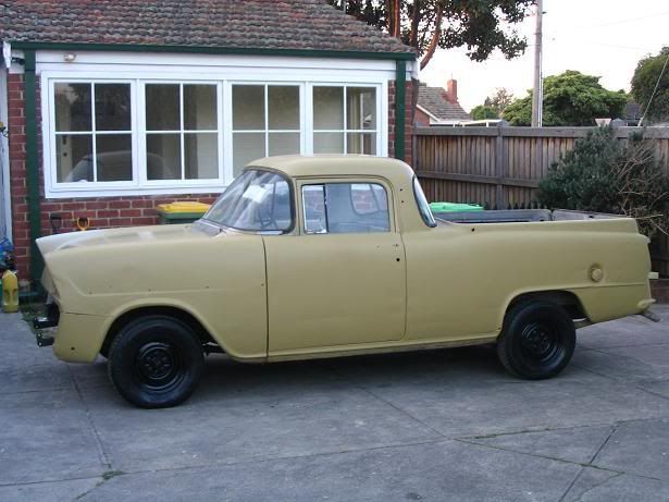

With a sample of the colour Tuscany Yellow

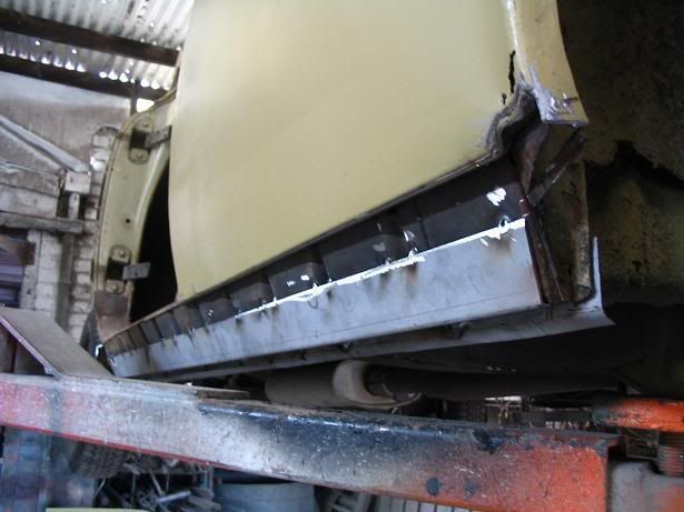

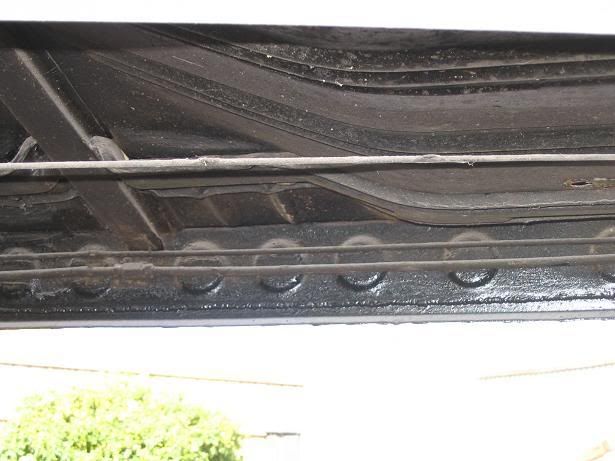

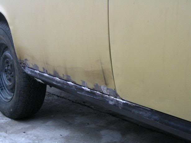

Next it went to Just Rust in Melbourne to have inner and outer sills replaced new k frames and extensive welding and rust repair work
they did some great work managed to weld the original circle pattern on the new inners

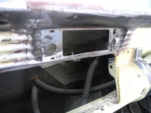

Got the new dash welded in thanks to Blacky!
Back home prep work started drivers side complete in black guide coat
Final stages on passenger side to go
Enjoy the pics

Hey Greg the rust and welding work took approximately 2 months but that was over Christmas and New Years so they were closed for a week or so. All up the work came to $2200.00 plus i supplied rust repair sections (my best friend works at Rares) Compared to quotes of $5000+ I was quite happy with the price and workman ship

I like your second pic , Mine was undecoated in the same colour years ago :) .
