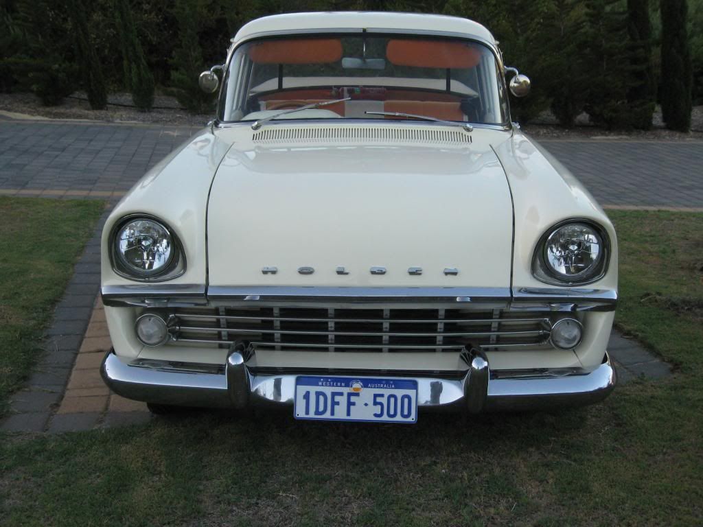

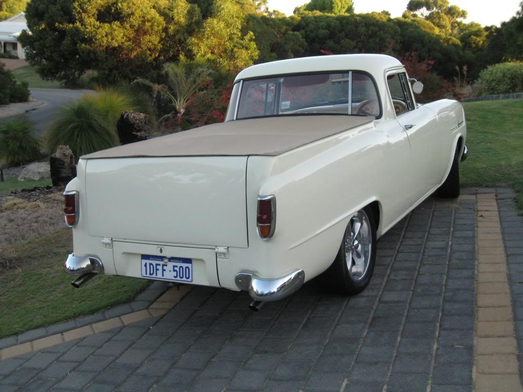

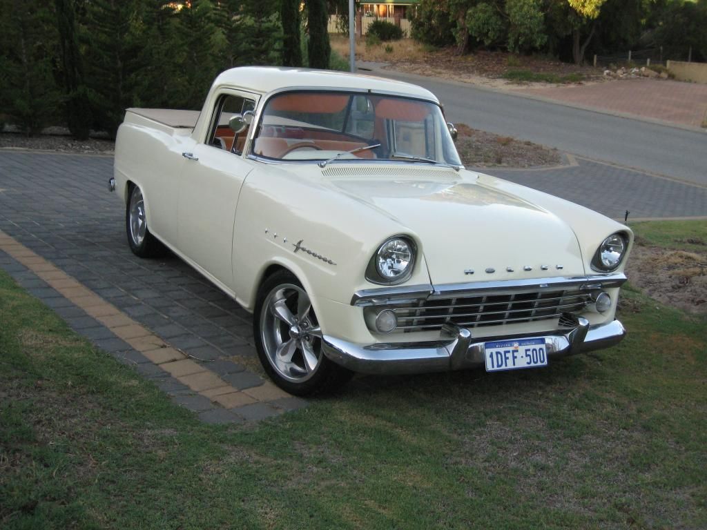

Hi Guys, Been away for some years now and arrived home to lift the covers off my car. Some of you will remember it from 2008 and I bought it in Aug 2009. Spent some dollars on it to get it over the pits and still have a bit to go to get it right. I had to laugh at Blackies comment in Aug when he came across the car and I can confirm that the steering is absolutely shite. I don't want to go anywhere near a carpark unless it is after 12.00am so I really need to do something with the CRS front end, some suggest I should throw it out. If you are reading this Paul, check out the missing join in the windscreen.
Anyway thanks for having a look at it, that's if I have done the photos right.

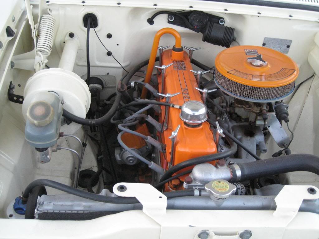

Oh, I forgot the important bit, the motor :vecctor:
