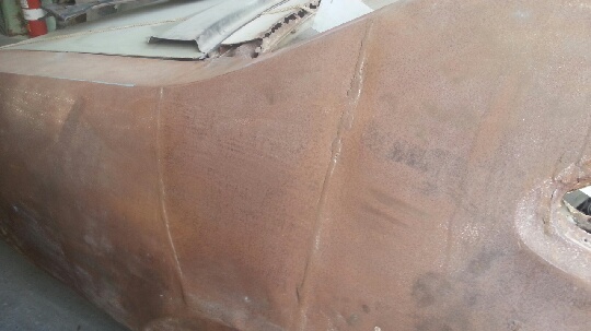

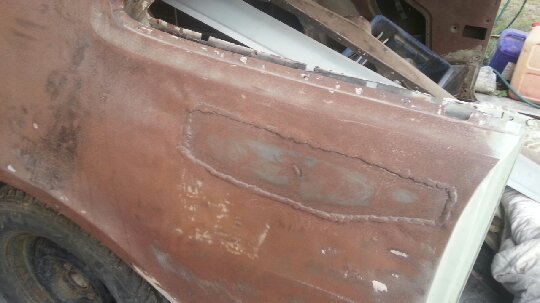

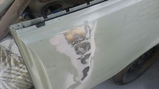

A mate bought this in the other day for me to resurect.
It had been at a panel shop for four years being done. My mate believed it was being restored properly.
He already has 30 grand into this project.
I dont usually bag other peoples work but this is nothing short of a disgrace.
I have never seen such bad work done by a professional shop.
My mate was almost crying when i dug out all the bog to show him what they had done. It was 3/4 of an inch thick in places.
Ive sourced another roof and quarter. Both of the replacement panels need lots of work but at least i can repair them properly off the car and then fit them.
The original panels are warped all over the place.
All of the hanging panels are repaired just as badly.

Kinda looks like what you would expect from a $3 000 job not a $30 000 job - thats butchery not panelbeating (no offence Trev :lol: :lol: :lol: )
Re: ht monaro
Posted: Tue Jun 18, 2013 3:37 am
by Trev
Another Monaro owner with too much money! $30k for that! :roll:
No offense taken Blacky, I was going to say it looks like an electrician got their hands on it :wink: :lol: .

This wasnt a job done to a price. The guy that owns this car just spent $120000 getting a 67 mustang fastback done. There was an open cheque book on this job and the guy believed he had a reputable guy doing the job.
The guy either didnt have a clue or didnt give a shit.
He must have used tweny kilos of bog. I really feel sorry for the guy.
Im going to do the metalwork and then get him to take it back to them and show them.
Its not about me wanking off that im better. Ill be using bog as well but only a fraction of what i pulled out.

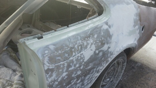

Getting back to the monaro the roof and quarter im using came back from the blasters.
The roof is fine but i will almost be remaking the quarter. The roof cost $1500 and the quarter $2000 to buy not including the time it to for me to unpick it and get them blasted.
These cars even the ones that arent rusty yet are ticking time bombs. The way the cant rail and quarters are constructed just promote rust.
