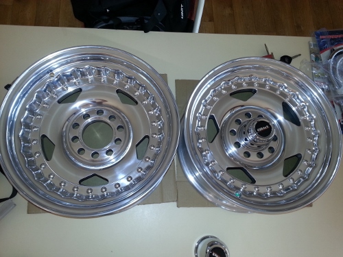

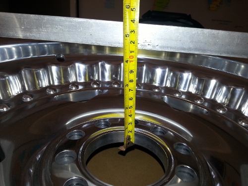

I currently have 95mm clearance between my brake drum and the rear guard,
I have purchased 15x7 street pro's for the rear and need 113mm plus tyre bulge (maybe 20mm) = 133mm.
I there for need to cut my 10 bolt down by 38mm each side.
It would be easy to stick with shallow dish HQ stud wheels but thats not the look I am after. I wish it was, it would be loads cheaper!!
I was unable to get much info on the cheaper street pro's (than convo pro), so I took a gamble and ordered some to check it out for myself.
The street pro's meet aussie standards as the convo's do not, the look pretty good, 1 piece full alloy.
