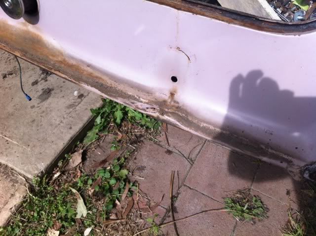

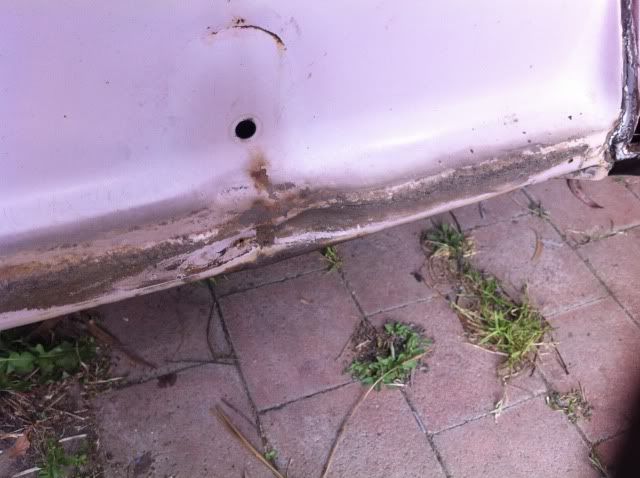

Can someone please tell me if these little "dents" on the panel behind the bumper are meant to be there ? The car's had a whack in the backside sometime in it's life, and when I got it the bumper was pushed up against the panel.

pretty sure no, when hit it's where the bumper joints hit the body

Hmm thanks Mick and Tim , I think you're right :thumbsup:
Nothing a bit of bog won't fix :oops:,, though something tells me Dave won't have a bar of it :mrgreen:
I'm beginning to think they are factory dents! Mine had them, the one I parted out has 'em and my mate who has an EK said all three sedans he's had had similar dents...:mrgreen:

Yeah mine had them too! :mrgreen:
Think yourself lucky you don't have a towbar.... :shock:

Mine has them too.......unfortuneatly they aint supposed to be there mate .......get the FBH out and go to work .....Fingers

I suppose because thats where the mounting bars for the bumper sit, all it takes is a little nudge of the bumper and the dings appear.

was the paint chipped where the dents were ,if not its meant to be there ,ive got a feeling they are for clearance and it would be a shame to fix it then dent it again.
id try the bumper on for size.

Ya made me think there for a mo Harko....... so I just went and checked a NOS Beaver panel I have in the shed and there is no dents in that either ........that first photo the recess looks pretty neat huh !!!....but no I dont think they are a factory thing ..........Fingers

Definately not factory. Checked both of my wagons 1 doesnt have them the other does and they are different sizes. The bumper bracket is still on the car and is bent. Guess what the bracket lines up with.

Nah, Cal - they are the result of the bumper irons making contact. If you take a closer look in pics 2 &3 - there's evidence of the over-rider having made contact with the end panel as well......
Like Stewart, I left mine - the potential for damaging the factory welds and sealing by attempting panel beating was beyond feasible risk for consmetic gain.... hidden by the over-riders. It might also "just" save you need from repairing paint if it gets nudged again..... bog will fill it - but a further nudge is only going to push that dent further in.... and crack the bog/paint....
The fact that most have gone to their vehicles to take a peek - states to me that they are not obvious, to the uneducated observer....
I'd leave the dents from the irons and only clean up the end panel....... your call.....

Thanks Rosco. I'll probably get Dave to leave the dents there anyway, as you can't see them once the bumber is on.
