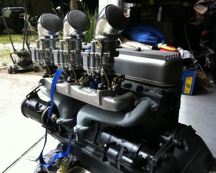

I've received a few PMs in recent months about the "frogmouth" airfilter units fitted to the Holden Stromberg carburettor. Although listed under the "Parts and Suppliers" thread, I thought I would start one here to make it a bit easier to find.
The frogmouths were manufactured by Alan Fountain, whom can be contacted on (02) 4392 2215. Take note that these are made for the Stromberg 97 carb and that a spacer is needed to fit them to the Holden Stromberg. These spacers are made by Alan's son; and they may need a little grinding to fit (which was my experience).
I found that there was some slight porosity on each frogmouth I purchased, but these are minor blemishes. As you can see, they do look the business.
My hopped grey
Hopped up grey in FB belonging to forum moderator "Thommo"'
Triple Strombergs built by "Parisian62" destined for his "Old Timer" old school EK wagon

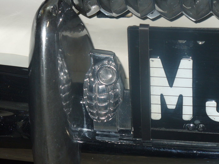

And contrary to popular belief the fitting of triples won't turn your grey into a hand grenade :lol: :lol: :lol:
