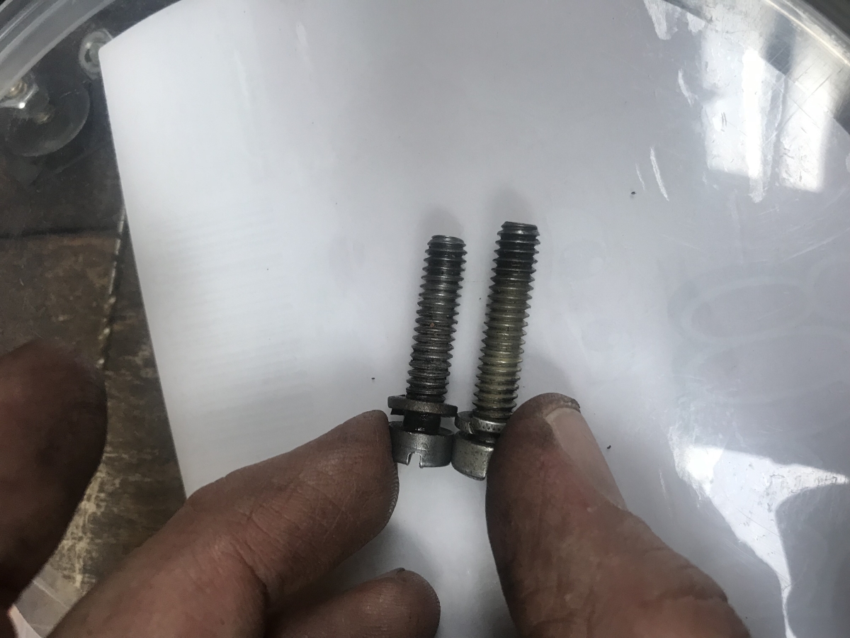

An interesting story to share. I helped out one of the humpy guys late last year. He had a grey motor Strommie that had been overhauled by a carby mob, but had never run right over the subsequent year or more... missing and farting at random during idle, cruise and power :sick: . He had checked all the electricals, and was pretty confident it was a carb issue.
Shipped the carb to me, and it was clear that it had been overhauled then used. Bright and shiny, with a few greasy/dusty marks from where the humpy was being driven.Took some care stripping it down, and other than a small amount of crap in the bottom of the float bowl everything seemed fine - jetting, gaskets, settings, clear passages etc. The only thing that was a little off was that the two screws that hold the throttle body to the main body were different lengths:
The attachment Optimized-short and long main body screws.JPG is no longer available
I figure the carb shop had grabbed some random screws, and picked two that didn't match. Shouldn't make much difference methinks... until it was time to put it back together. The holes in the throttle body (black ion the photo below) are drilled and tapped through (not blind). However, the threads in the bottom of those holes are burred, meaning the screws will bottom-out before passing through the throttle body. When reassembled, the short screw tightened up before bottoming out... the long screw however bottomed out, leaving the throttle body/spacer/main body joints all loose. The poor old carb was sucking in air through the loose joint. Looking at the grease/dirt marks on the main body, you can see where it was blurting out crap on occasion from the open joint:
Optimized-short and long main body screws.JPG (496.84 KiB) Viewed 25960 times
Swapped out the long screw for a short one from the spare parts department, and gave the carb a test run on the FB (before I burnt the brakes out :oops: ). All good, and the carb returned to the owner. The humpy now runs like it should.
