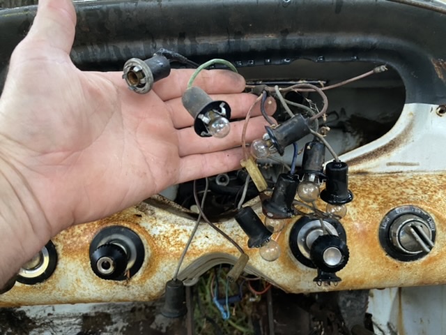

From memory, the globe holders are the same ones as the gauge cluster lamps (I could be wrong though) - if someone has an old harness, they may not have the license plate lamps but will probably have 1/2 a dozen gauge lamps hanging off the spaghetti.

I’ll be scavenging an old harness to see if I can find some globe holders in the dash area for the rear number plate lights

FbSTDwagon
Posts: 790
Re: licence plate lights
Post by FbSTDwagon »
Thanks fellas for offering the assistance but I found a good stash on the carton of beer car!

FbSTDwagon
Posts: 790
In the Shed wrote: Wed Mar 16, 2022 6:50 pm The pics of the lenses look like the sedan, Drew has a wagon. I thought the lenses and maybe globe holders are different?
Same glove holders with different lenses I think Stephen!
