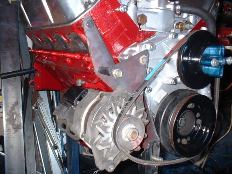

Why were you using a JE Camira alternator Ed ?
Re: ek wiring with 1uzfe
woefully cheap... small, yet powerful enough to run all the electrics at 60A.
I made a custom low mount that solidly mounted it where the fuel pump normally goes on a 308. It was nestled nicely between the subframe rail and engine block, belt tension was using an idler pulley.
this is about the only pic I have, because you could hardly see it when it was installed.
you can see the idler pulley adjuster doubled up as a fuel pump block off.
Ed
Ed
