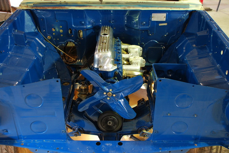

Morning all,
Finally I have gotten back to the front end of the car and have finished re-building the two carbs going on my grey. Now comes the fun part of linking them together. I know American Auto Parts along with others have a linkage kit to suit but do they fit the dozens of varying intake designs produced my umpteen different manufacturers?
I have heard of others who have had success with a spring operated setup, doing away with the shaft and all. We are considering ditching the whole linkage system across the firewall and fitting up a throttle cable. One issue is the the go pedal pushes rather than pulls but we think we have a solution for that.
If you have photos, info, left of field setups! please upload them. If you have high-resolution big files, email them to me at sponge_designs@hotmail.com
WANTED: Twin carb linkage images, set-ups, ideas...
