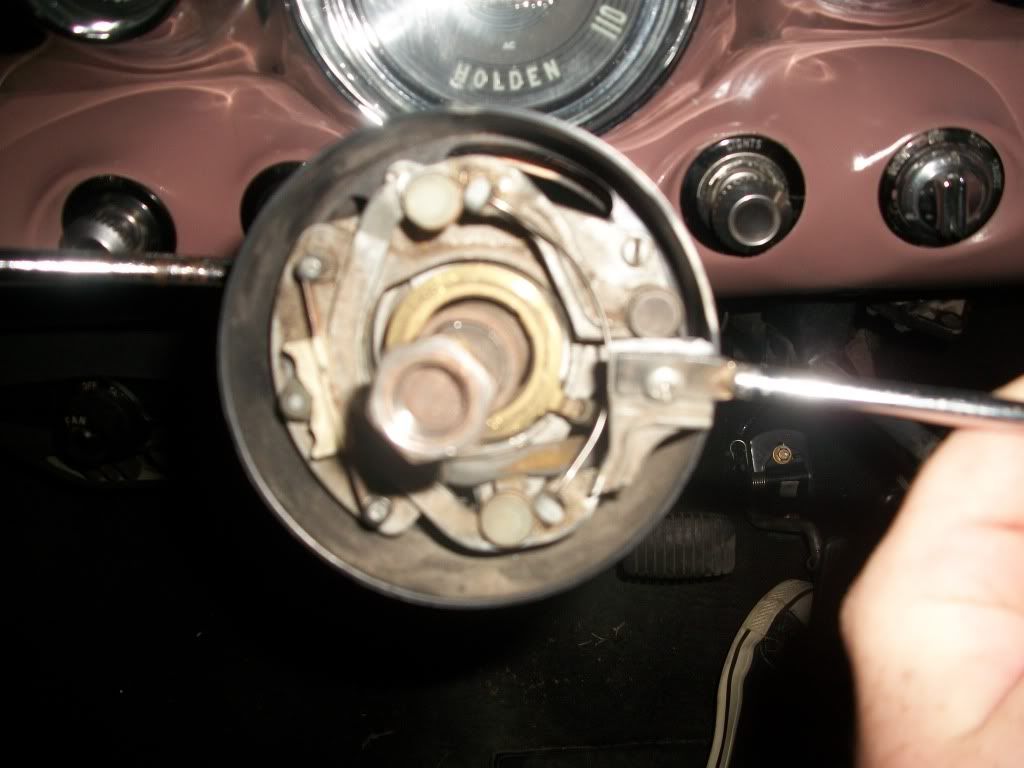

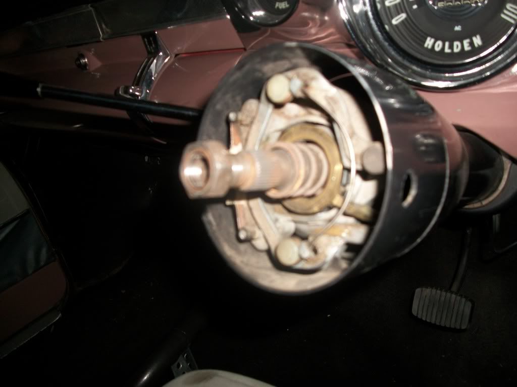

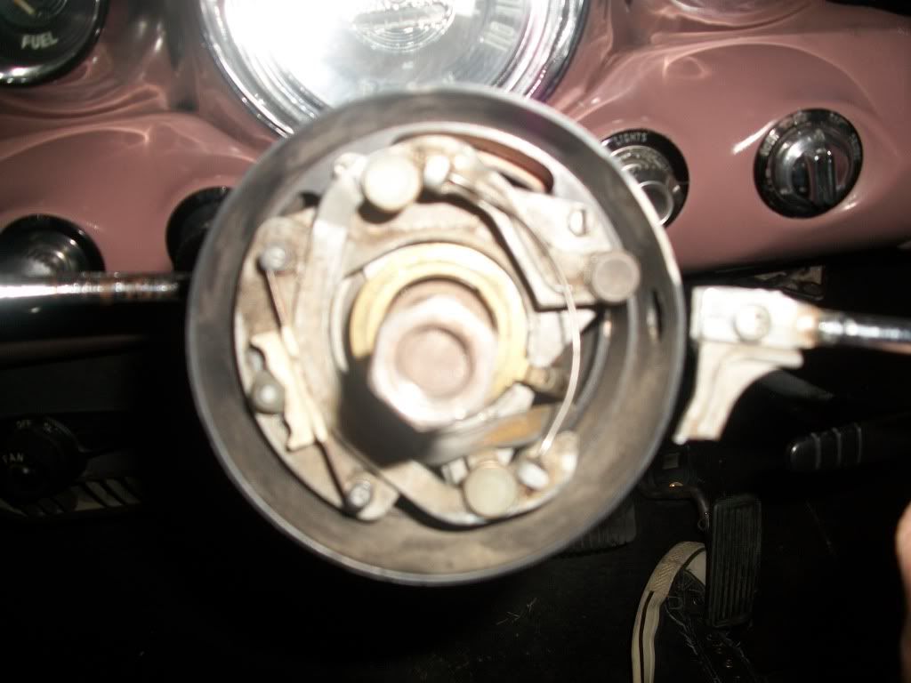

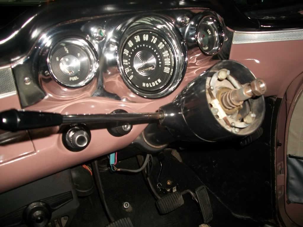

Hi all, just ripped the steering wheel off the FB to fix the indicator which had snapped at the stalk.
Devilrod in all of his kindness gave me a spare to replace it with. Just got home and pulled off the wheel and then realised it aint a BLOODY FB or EK steering column.
If anyone know what its from can you please inform me so I can try and get the appropriate bits.

Just been hunting and its from EJ to HR.
Dave.

looks like Hd Hr to me
EJ EH has cast outer housing
HD HR has a plastic outer housing

Definatly plastic outer.
Dave.
Posts: 4344
Re: Steering column, whats it from ????
and gear stick is definately HD/HR but the blinker mechanism is the same from EJ-HR
